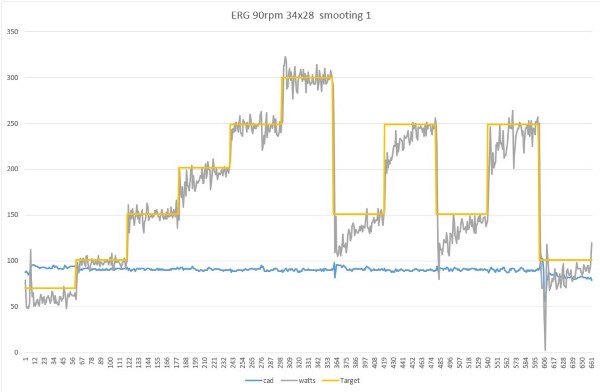

First is ERG interval, keep RPM of about 90 power smoothing set to 1, 34x28 gearing:
- ERG 90rpm 34x28 sm1 (Klein).JPG (39.47 KiB) Viewed 44264 times

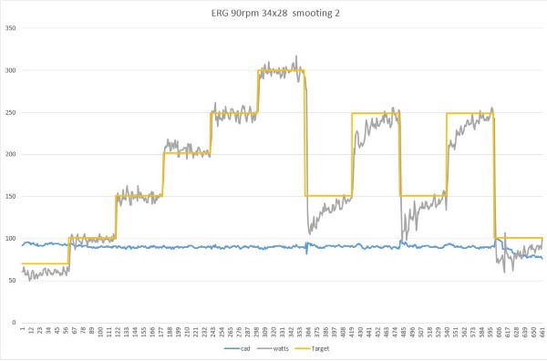

And after changing the power smoothing back to default (2). Increasing it even more will lead to more noticeable delay when stepping the power
- ERG 90rpm 34x28 sm2 (Klein).JPG (40.49 KiB) Viewed 44264 times
You can clearly see the effect of the power smoothing, it dampens the variation in power read-out
This is actually the best I can get in terms of respons to a power change. And I would actually be quite satisfied with this performance. I mean look at the first 5 steps. Nice. Ok, the steps down are not good, but they do not really matter. I can live with that. But what happened in the last 2 power increments? Here we see a noticeable delay again. I saw this often. I can not help to think that the delta in power step might be of influence as well.
