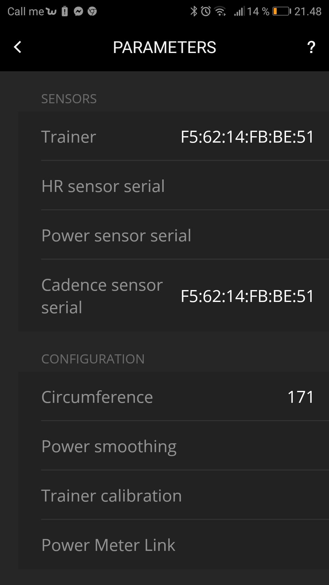

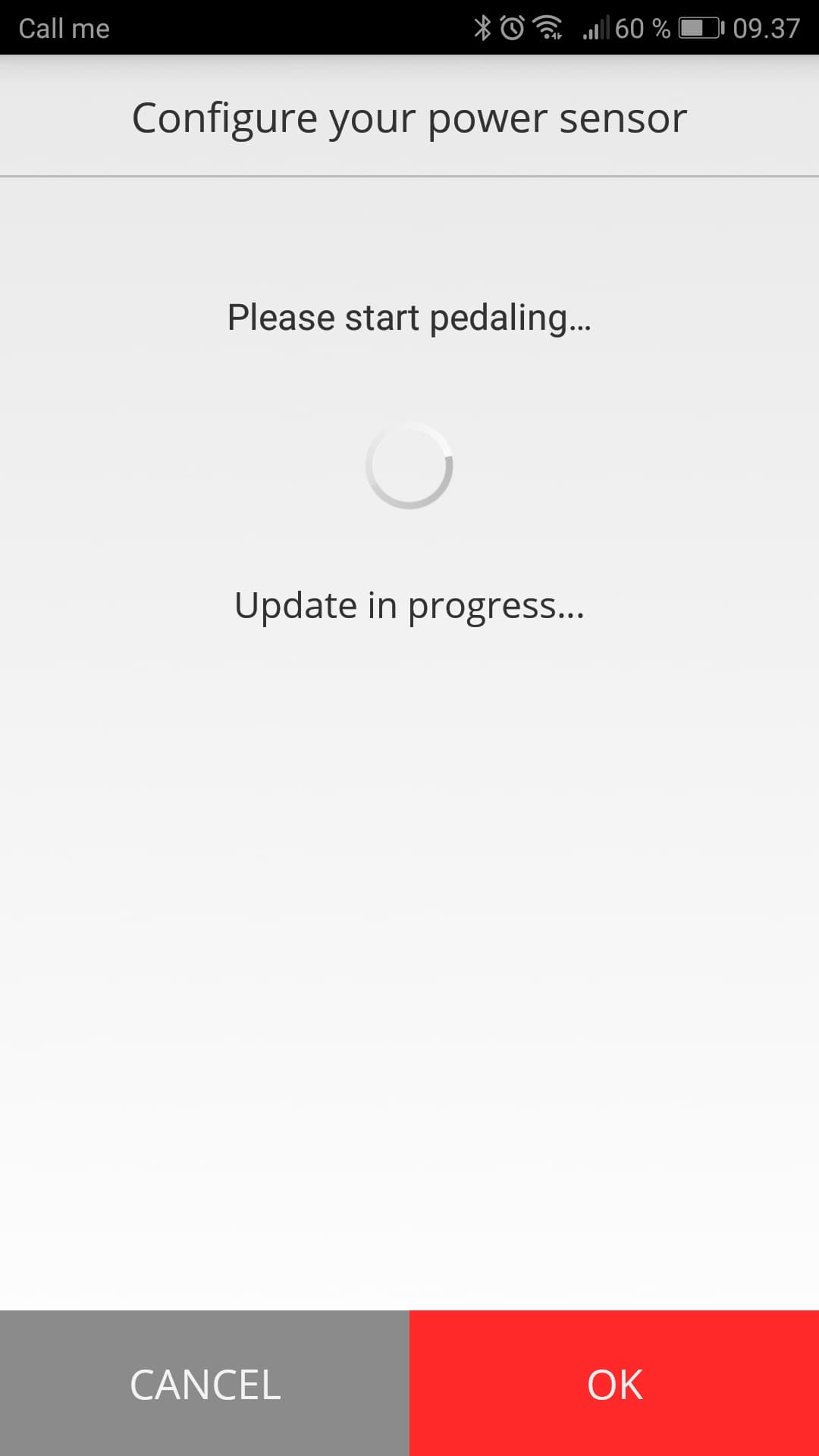

When I try to configure my new Elite Direto in My E-Training nothing happens, when I start pedalling. I am still able to calibrate it, but the app cannot find the power sensor serial?

I am having the exact same problem. I use my trainer with Zwift, but set up back in early 2018 with myetraining app to configure and it worked well on Zwift. I noticed everything seemed to get too easy to climb in Zwift... 9% gradient felt like 3 or 4 used to... so I went back in to configure on myetraining app. After trying, it would not set up power sensor just like shown here. I figured I would just go back and use Zwift and try again later and now there is almost no resistance even on 11% or higher gradients. I only changed trying to set up and configure again. HELP!! I need to at least get my Direto back to where it was before.
These data are only used for training within the My-E-Training app. The power meter is only populated if you have a separate power meter.
