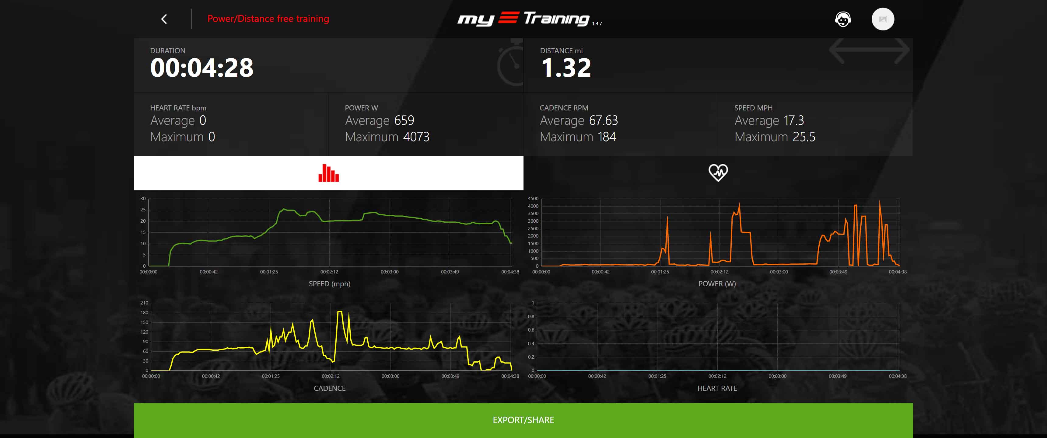

I did a few experiments. Tried it on the windows myEtraining application, with a bluetooth connection, and an ant+ connection. And I tried it using the mobile phone app too, over bluetooth, just to rule out any problems with my Windows PC.
At about 18-20.5 mph the power meter goes crazy, spiking to up to 4000W. Above and below those speeds it seems fine. So the trainer looks to be faulty.

Quick update, I contacted the retailer who asked me first to speak to Elite to see if they knew what the problem is. Elite suggest it's a mechanical fault, so the retailer is collecting it free of charge to deal with.
