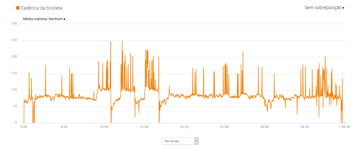

Cadence numbers in myetranning not working so well. When I use myetranning app, results are inconsistent for cadence (see attachments). When I use trainerroad app, with the same equipament, the results are fine.
Equipament: Elite rampa with Garmin Bike Speed Sensor and Cadence Sensor

Hi Carlos
Are you sure you've paired properly the cadence sensor?
Can you post a screenshot of the advanced settings in my e-training app?
