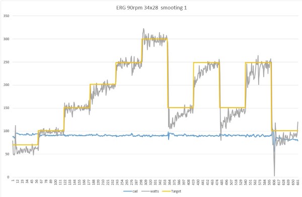

First is ERG interval, keep RPM of about 90 power smoothing set to 1, 34x28 gearing:
ERG 90rpm 34x28 sm1 (Klein).JPG (39.47 KiB) Viewed 44263 times

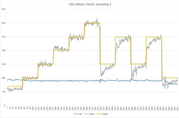

And after changing the power smoothing back to default (2). Increasing it even more will lead to more noticeable delay when stepping the power
ERG 90rpm 34x28 sm2 (Klein).JPG (40.49 KiB) Viewed 44263 times
You can clearly see the effect of the power smoothing, it dampens the variation in power read-out
This is actually the best I can get in terms of respons to a power change. And I would actually be quite satisfied with this performance. I mean look at the first 5 steps. Nice. Ok, the steps down are not good, but they do not really matter. I can live with that. But what happened in the last 2 power increments? Here we see a noticeable delay again. I saw this often. I can not help to think that the delta in power step might be of influence as well.

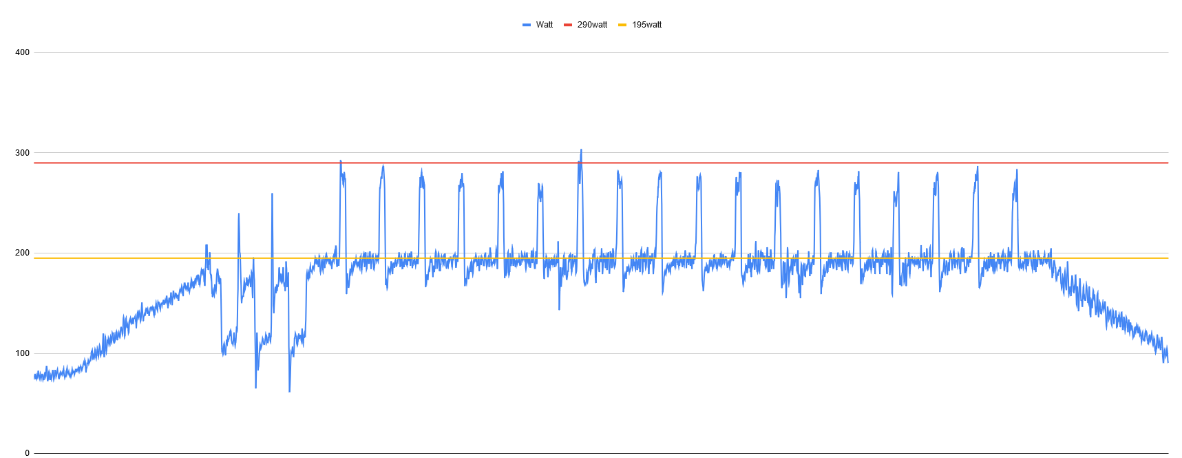

I also contacted the Elite support, and they also told me to create a custom workout in the Elite app. I rode it twice, once with on my 50T chainring and once on my small 34T (middle of the cassette in the back). Both times the smoothing was set to the default value of 2.
The ride was clearly smoother when on the small ring. When on the 50T, the trainer was even unable to lower the power to 100watt (as you can see in the last block).
Elite told me the results were looking fine, but advised me to set the smoothing value to 6, and test again. I did not yet had the time to do this new test in the Elite app.
I did however test the smoothing 6 on a Zwift ride (see second screenshot). The power increase and decrease at the end and start was very good and felt smooth. Also the 190watt blocks felt smooth with little to no issues. (It had some trouble the first couple of seconds, but I think thats normal coming from a fast spinning flywheel with the high watt blocks).
The only problem I had was with the sprint blocks. In the 20sec sprint blocks I could feel the resistance kicking in as soon as the block started, but only not hard enough. I almost never hit the set 290watt in the 20sec block as you can see in the screenshot. The cadence is not in the spreadsheet, but I can assure you, I was focusing very hard on it being as smooth as possible :lol: (rpm +-90)

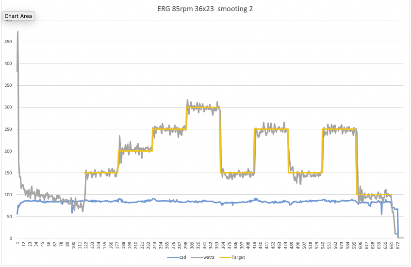

Just performed JohandeWit workout in Zwift, and here are the results. The test was done with smoothing 2, and a 36x23 gear. Ignore the first seconds, it got stuck with the ERG bug, and had to put some watts to get it moving.
Screen Shot 2020-11-24 at 6.45.35 PM.png (156.32 KiB) Viewed 44146 times
Quite happy with the results to be honest. My Direto XR after manually adjust the belt, has the calibration only 1 value from the value written under (before it was like 4).
