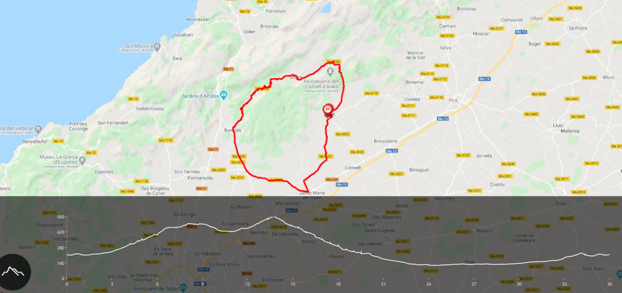

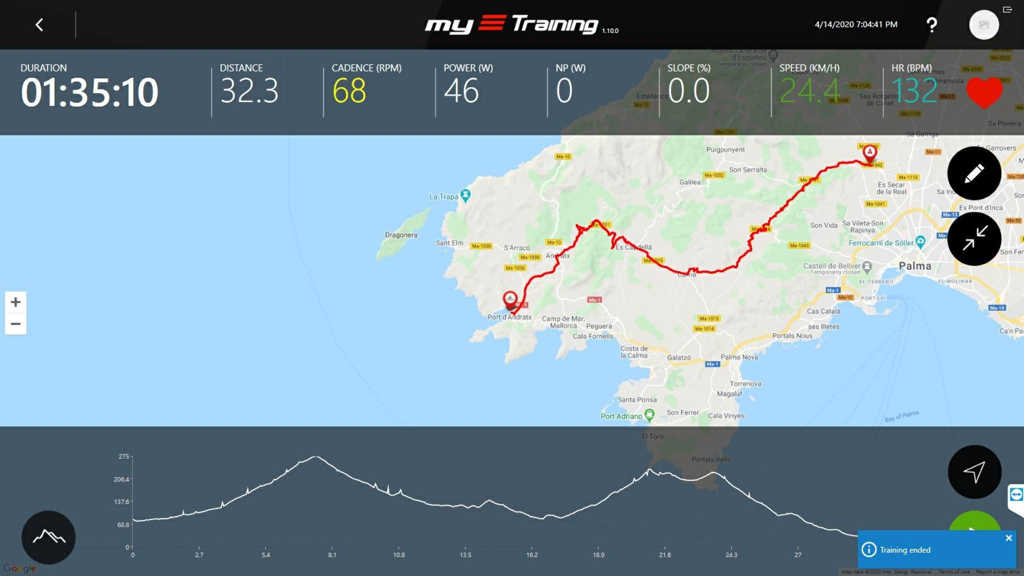

Since the last software update, after uploading KML files as a Map Course I'm seeing little 'spikes' in elevation on the route profile that obviously are not 'real'. (see attached example screenshots). These spikes are usually significant in gradient and whilst you might expect to go from 5% to 13% whilst climbing hitting a 15% ramp on a 5/6/7% descent whilst thrashing your 50/11 gear is a bit of an issue.
To narrow down where the problem is I have created KML files s using different file converters and reviewed the same KML files using different KML viewers and it is only when they are imported in to My e-training that the spikes are created.
Anyone have any ideas? Is it just a bug in My e-training?
I'd like to get rid of the issue as it is a real irritation.

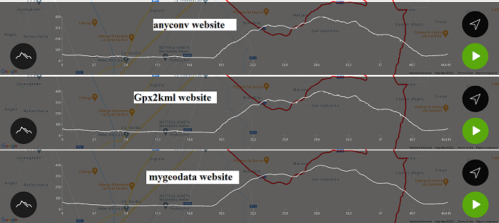

Dear all,
I've faced the same issue (spikes in the elevation); i've maked some test with different website to make the conversion from gpx to kml. The spikes was solved using mygeodata website --> https://mygeodata.cloud/converter/gpx-to-kml .
Ciao a tutti,
Ho avuto lo stesso problema (picchi nell'altimetria); ho fatto alcuni test con diversi siti web per fare la conversione da gpx a kml. I picchi sono stati risolti usando il sito mygeodata --> https://mygeodata.cloud/converter/gpx-to-kml

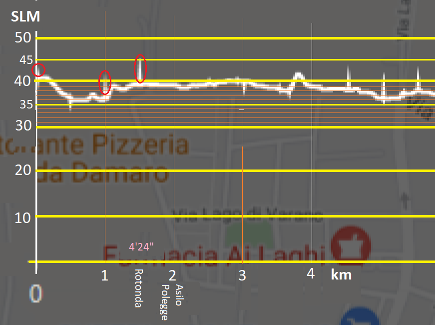

Stesso problema anche per me. Esportato la traccia GPS da Garmin e convertito file GPX in KML.
Quando poi importo il percorso in My e-training sul tracciato appaiono picchi di altezza assolutamente inesistenti, e moolto fastidiosi per la pedalata.+
per togliermi la sfizio ho esaminato i dati originali GPX e quelli convertiti KML, e i valori dell'altitudine sono assolutamente lineari, senza sbalzi.
