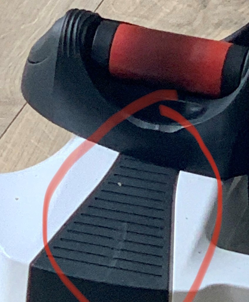

Re: Elite qubo digital smart b plus - tyre hits trainer
Seems it can only be a very small file so the quality is quite limited - you can however clearly see that marks that the tyre have made into the plastic bits

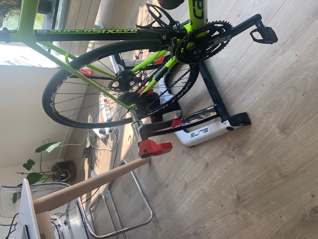

Can you send a photo from a longer distance so I can see better how the unit has been mounted?
I ask you this because it seems on the wrong side
- Posts: 7
- Joined: Tue Jun 16, 2020 9:14 pm
Picture 1
- IMG_5111.jpg (102.5 KiB) Viewed 10248 times

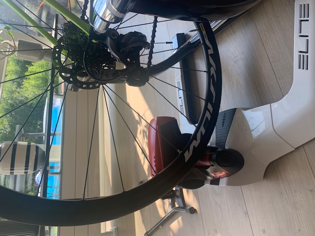

Picture 3
- IMG_5114.jpg (95.4 KiB) Viewed 10248 times
It's properly mounted.
Can you check if you have used the external holes to fix the unit of resistance?
If it is so, use the internal ones and this should solve the issue.

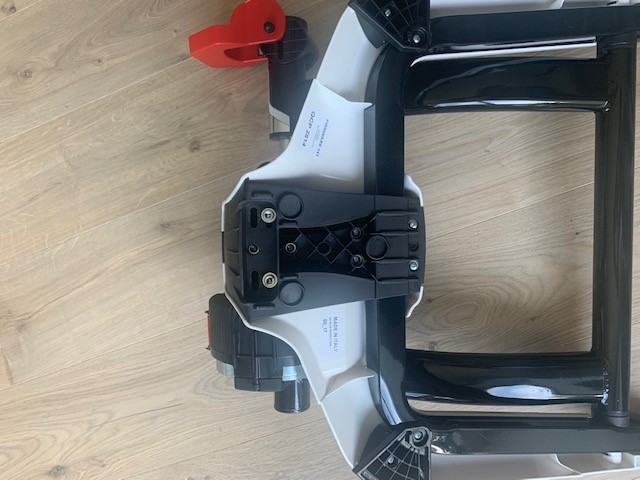

Not quite sure what you mena by internal or external holes
- holes.jpg (75.29 KiB) Viewed 10221 times
It's all correct.
The problem we suppose it's on the wheel dimension and bike frame.
I've asked to our quality department and they suggest to use a travel block under the frontal wheel and also to check to have properly inflated the wheel at 7/8atm
