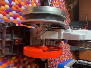

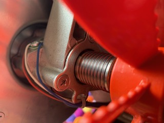

1st gen Direto been working great for 2 years. Now, horrible noises when I pedal and power readings all over the place, this started to happen after belt tightening and calibration. belt is in perfect condition and black roller is fine. There is however a lot of play in the axle that runs the flywheel and red fan. Fan and flywheel move independently a little bit. Any ideas?!! Stuck in isolation with no trainer aaaahhhhrrrrrr.........

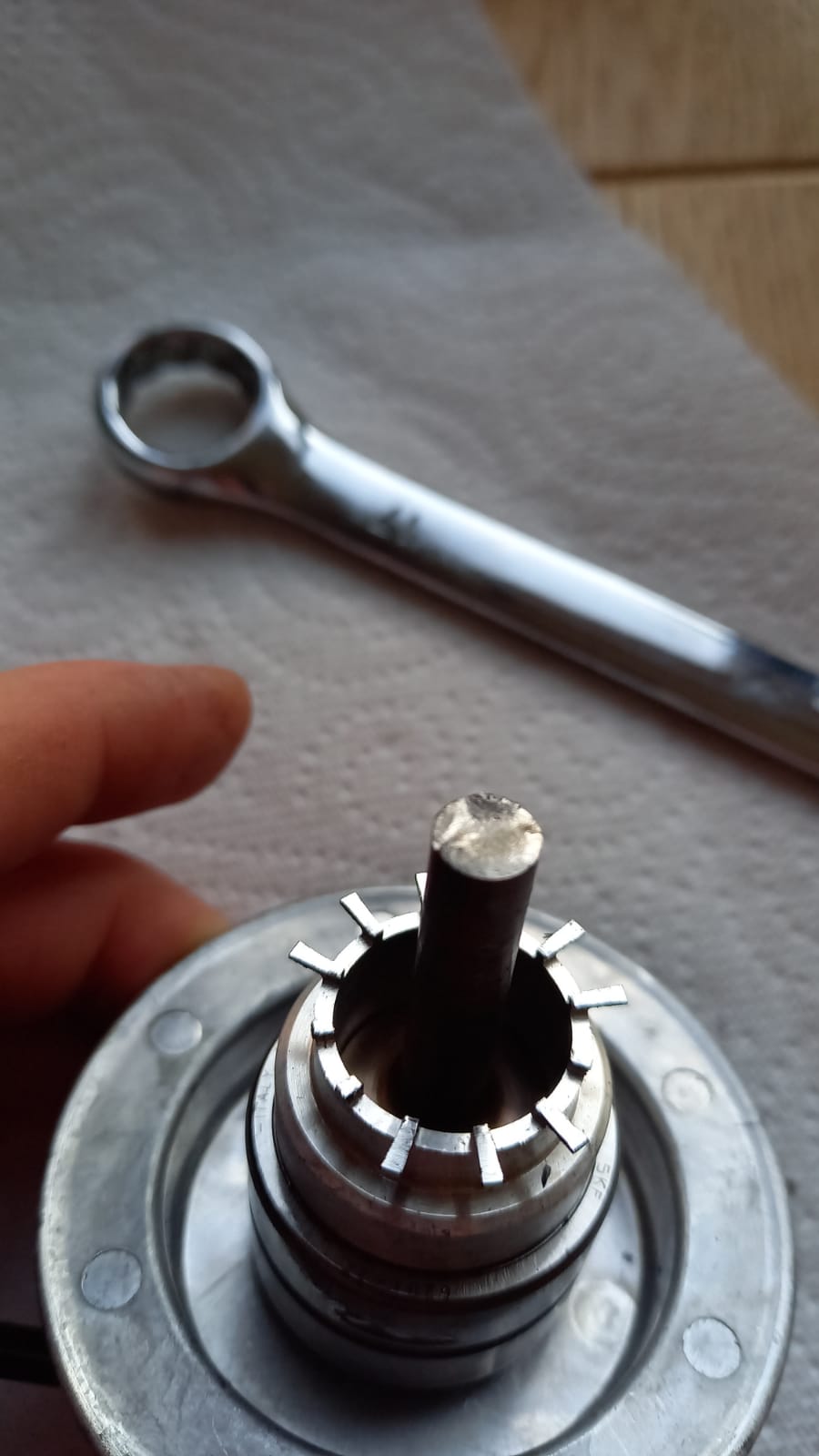

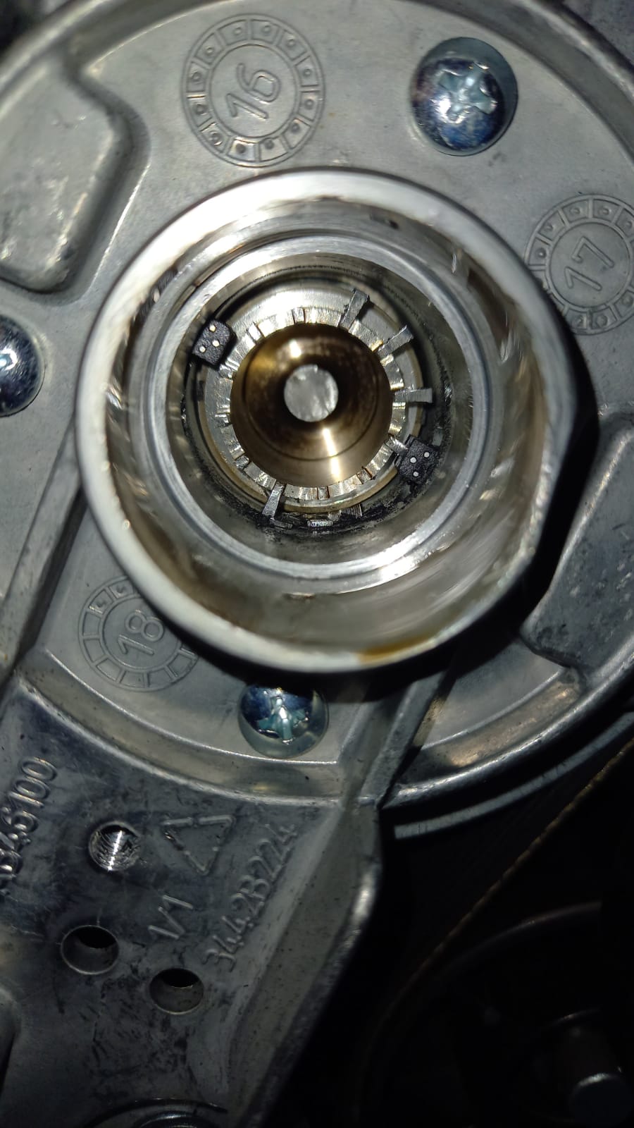

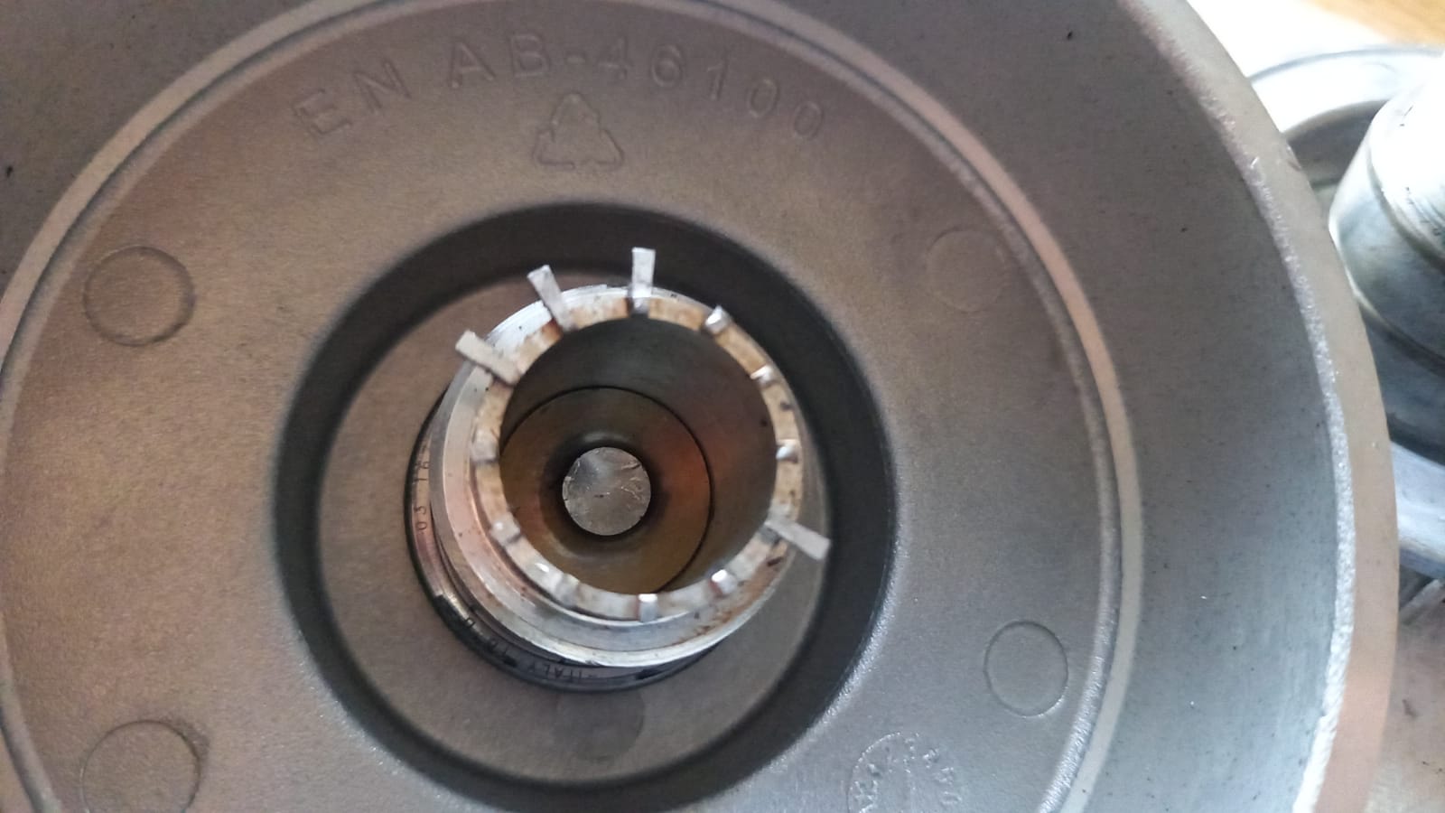

Same problem here. Just over 2 year old Drivo 2 (£1200 trainer) has just broken. Opened up to investigate and the axle has snapped!!! Hopefully Elite can offer a solution...?
