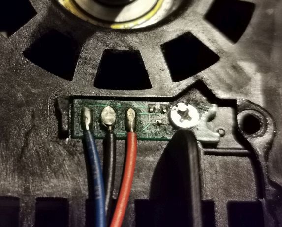

This sounds like what happened to mine, one of the magnets for the speed sensor came loose and killed the magnetic speed sensor.
I stripped my unit and I'm trying to replace the (very) small surface mount magnetic senssor, which was attached to that green printed circuit board in the pic.
