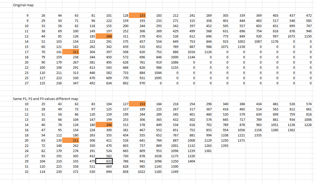

Have a look at my post (see ref below) as it seems we are having some similar issues as I'm finding the map response isn't correct.
'How to load setting file (tsv)' viewtopic.php?f=33&t=970
Furthermore by inputting the default values of P1,P2 & P3 as supplied by 'Elite' for my trainer the map produced by the software is different to what was loaded when the trainer was shipped! In other words the trainer will never respond as it originally did.
What I would like to do is upload a custom map to the trainer that suits me, but Elite seem reluctant to make the software available.
I've tried to attach image showing different maps for the same P1, P2 and P3 values, but not sure if the forum will display.
- Elite maps.png (50.64 KiB) Viewed 33712 times

Interesting.I can see your images and read your original post and dialogue with support. So what happened out of this?
Am I correct in assuming that you can't modify the factory burned algorithm (which creates a unique map or non-linear power curve), correct? So in this case, is it not possible to use very irregular power values for P1-3 in order to somehow get the trainer to simulate actual road resistance and corresponding power outputs? Or will it just hose things up even more. Their manual calibration test where you input your power meter's values into P1-3 at the varying speeds seems to bear no reflection to reality once put to practice in a training app. I have since resorted to folding up the Elite trainer, putting it in the closet, and using my Kreitler rollers with a head wind fan, using my bike's power meter. The training apps obviously won't be able to change the resistance of my rollers, but that isn't even necessary. I'm simulating the sprint lane of a velodrome...one fixed resistance! So I just adjust the resistance on my rollers with the headwind fan (which applies varying degrees of resistance), and find the resistance that matches what I see on the track.
