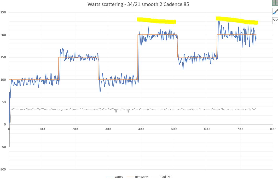

JohandeWit wrote:So I did some more testing today. First Elite asked me to sent them a csv file of a workout in POWER mode (100,200,100,250,100,300,100 Watt). I noticed that the XR reacted rather quick to a (manual) power change, see the picture (I ended up having my wife operating the mouse so that I could focus on maintaining rpm as smooth as possible :D)
So this triggered me to create a workout and repeat this in ERG:
Unfortunately during analysis i found I made a mistake (2nd block is not 250w), but nevertheless I would argue that in ERG mode the performance IS different than in POWER mode. It seems the lag is far more noticeable.I see this is most of my test runs.
Both test were made with 34x20 gearing.
oh oh I can only add 3 pictures so I will continue in the next reply.
Hi JohandeWit,
I made a test to check if in POWER mode the direto performs better in Power mode than in ERG, not only in reactiveness, but also in stability.
I made a steady 200W for 3, 4 minutes, and I made some analysis respect to a 200W sets in a ERG workout structured as 100-150-100-200-250-200.
Numbers say that the result in power mode are better (I would say not perfect,but better).
Tested with smooth = 2, 34/21 chainrings, cadence on 85 rpm (using the internal cadence sensor)
In ERG mode I 've excluded the first 10 second after the change in power, to let the trainer adjust the power
In POWER mode I've excluded the first part and thelast one in order to select the "best performance" of my cadence.
These the main results:
steady 200W power mode:
Difference in Power (WATTS)
< 5 64%
between 5 and 10 26%
between 10 and 15 8%
>15 1%
Higher delta 18 AVG of deltas 4.8
200W ERG mode (first set):
< 5 57%
between 10 and 15 13%
>15 4%
Higher delta 24 AVG of deltas 5.8
200W ERG mode (second set):
< 5 44%
between 5 and 10 25%
between 10 and 15 17%
>15 14%
Higher delta 28AVG of deltas 8.2
In POWER mode 200W I got 90% of the values under 10 watts in terms of difference on the request (in absolute values)
In ERG mode 83% best case, 69% worst.
In both tests, about 98% of my cadence was between 82/87 I would say "damn" stable.

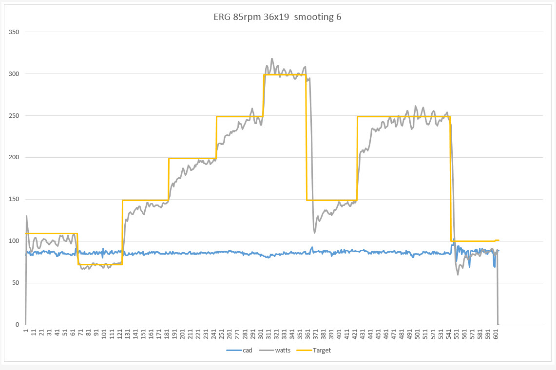

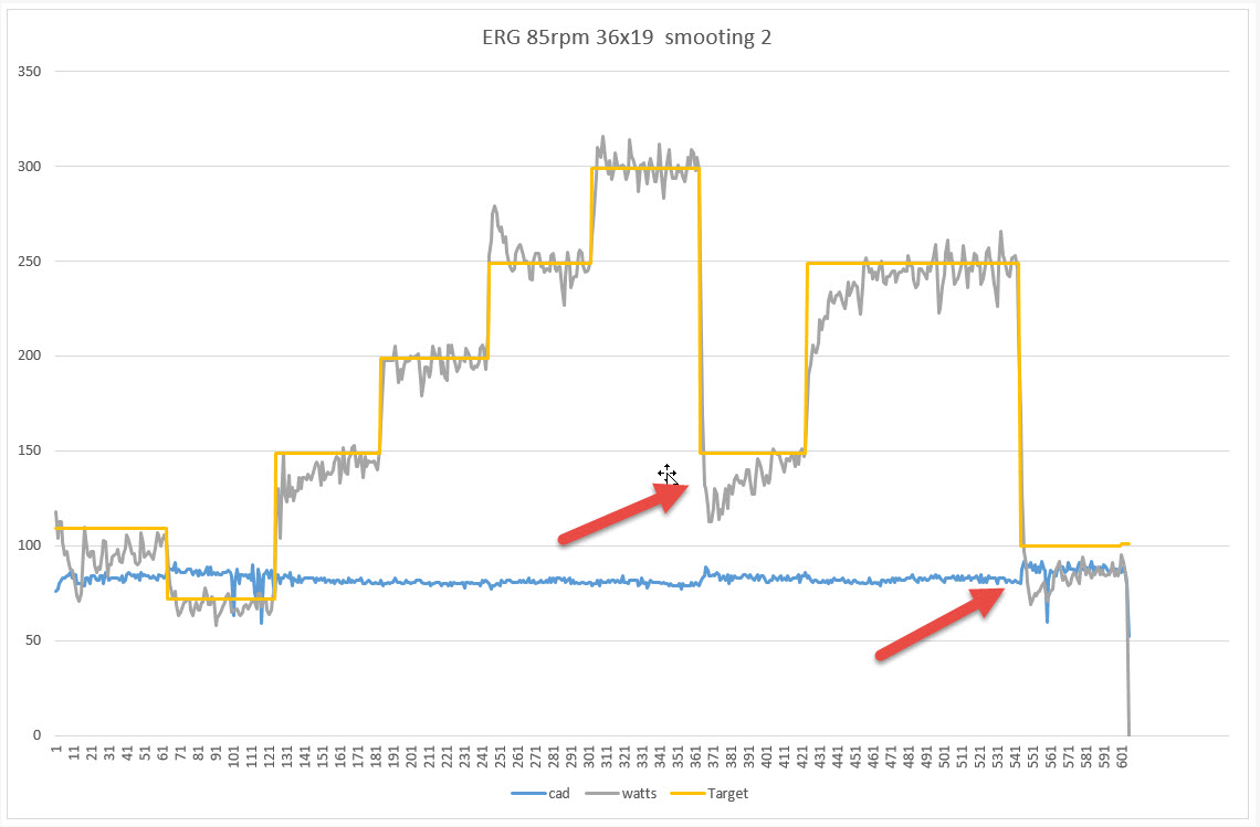

i break up training and did some investigations. last think I've tried was CALIBRATION in Elite app. after this step i could re-start training and finish it more-less OK but still far from perfection due to long "transition" time.
User story 3 with some pics:
I've started reading forum thread and found You guys having same issue. so I've done test similar to yours and put results into similar spreadsheet.
i did not realize that TrainingPeaks wrongly interprets ramp, so instead of ramp at the beginning of test i have 1 min@110W and 1 min @72W
i also by my mistake skipped transition from 250 to 150 and back to 250, but result is bad enough to share anyway.
Here most annoying is delay in watts adjustment on resistance drop. it drops way below target and in fact never reach target.
i could live with it once on end of work small rest is not bad :)
here, with smoothing set to 6 this delay hardly let trainer set resistance within 1 minute.
but my feeling was not bad in this setting at all. i felt continuous power without sudden steps. for longer intervals it seems to be OK.
I am not sure if I should bother Elite support with it - perhaps i will open ticket for this issue at least letting Elite know that not everything is OK.
