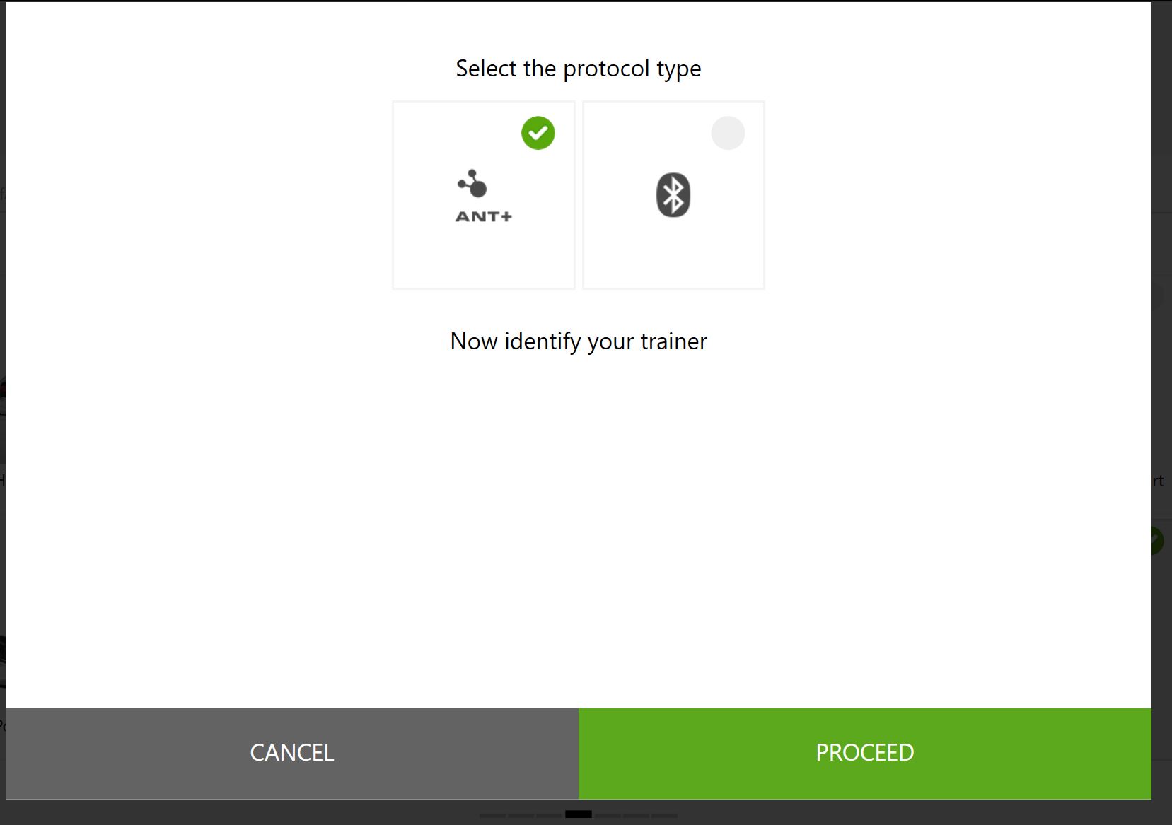

If this doesn't solve the problem, let's check the communication in the software (2).
When you try to pair the trainer, in the page where you have to select the communication protocol, the ant symbol has a red exclamation point over it?

The ANT+ Dongle had a tick in the top corner, there is no red exclamation point.
The trainer cant be communicating with something else, if I open up the bkool application it works fine.
If I open the app on my mobile it works fine it only doesn't work with the desktop application.

Here is the screenshot

Ok guys sorted!!!!
I was being a bit dumb and when ive picked the right trainer I can now select it :)
I think its resolved by two reasons...
1) me being dumb and picking the wrong trainer.
2) I saw on another guys post that it doesnt play nicely with garmin connect, I also uninstalled that......
