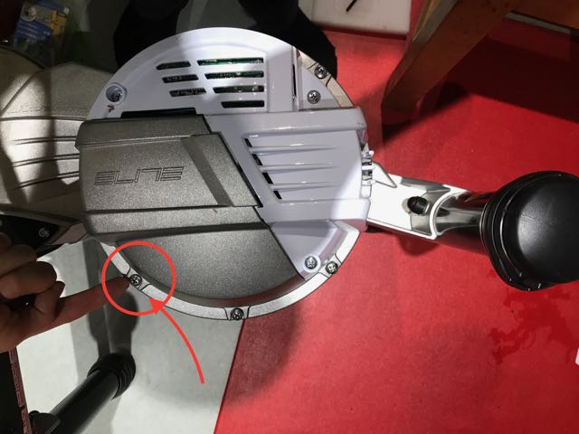

Unit leaking oil out of the bottom. Only noticed when taking a look to see if the cassette was lose or something as was making an odd 'tractor' noise intermittently once it warmed up (roughly 30 minutes)
Noticed the oil and then could feel oil at the bottom of the unit where it is screwed together.
tested the screws - one was able to be tightened half a turn. Could that be enough to cause a leak?
In which case - what do i do - can I add oil myself? to save returning the unit al the way back to Italy? Or is it already broken now that it's making the noise and I need to ask for a replacement one?

Photos reduced in size and attached
- IMG_6906.jpg (73.56 KiB) Viewed 28542 times
- IMG_6910.jpg (14.93 KiB) Viewed 28542 times
- IMG_6909.jpg (10.96 KiB) Viewed 28542 times

Hi Martin
I've been told that our customer care has suggested you to return the trainer to the shop for a complete replacement as to repair it you'd need special equipment. The technician that has followed your case is trying to find a solution regarding the return, please stay in contact with him to solve the problem.

What I did try was draining the original oil and putting in something with the same viscosity. I then sealed the unit with glue but It never worked I still had the same noise.
I put the original oil back in and put the trainer in a box in my garage where it's been ever since.
I gave up in the end! Madison said it couldn't be fixed and the warranty on mine had ran out. I lost out on 1000 pound trainer. Elites customer services are rubbish and I told them! Probably why they never replied to me.
Thing that annoys me is if it's mechanical as Madison said why could it not be fixed!
