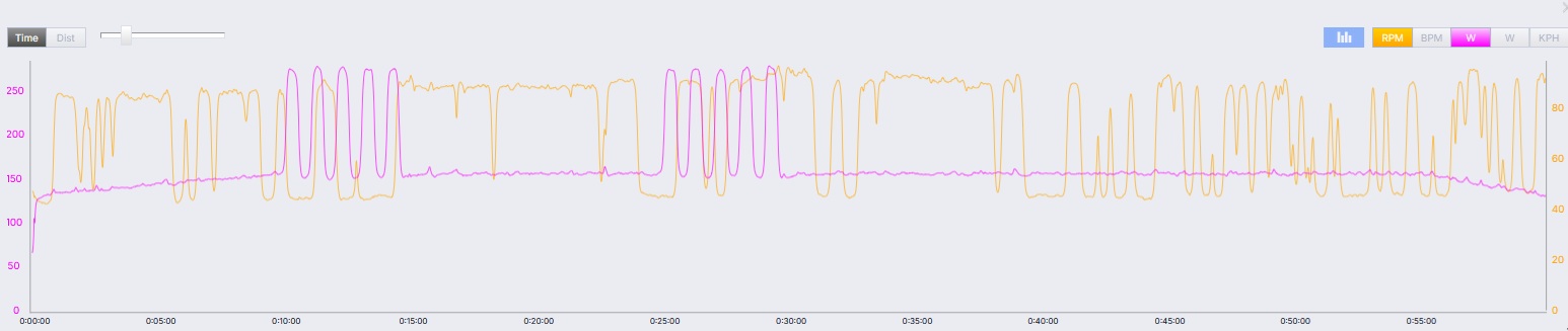

Unfortunately, I am now also having problems with cadence measurement :-(
And this has nothing to do with irregular pedaling!
For the first 24 months, my cadence was displayed correctly... but for the past few weeks, I have been experiencing constant drops in the measurement (instead of 90 RPM, it drops to 45 RPM for a few seconds/minutes).
