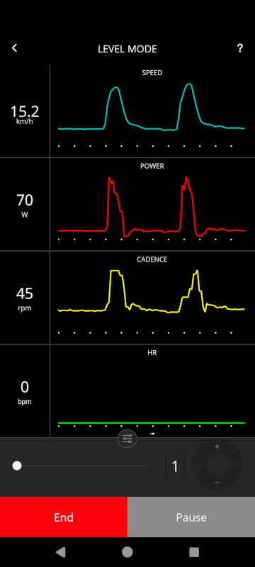

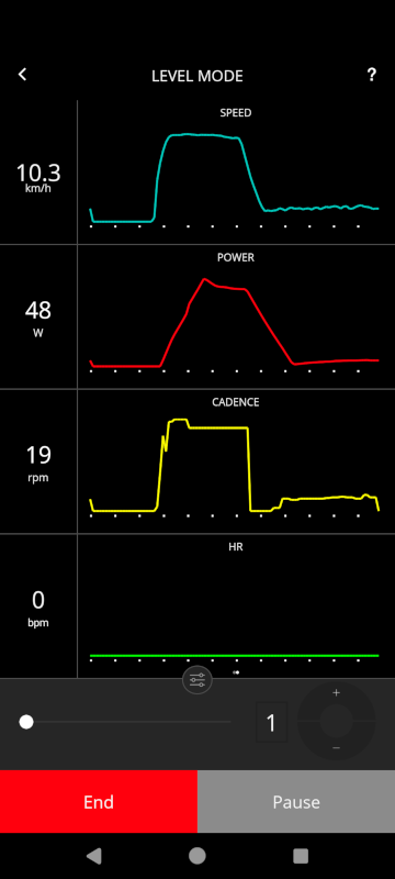

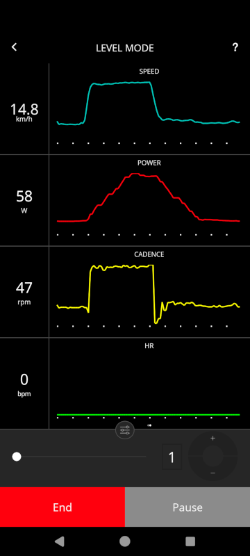

with Power Meter Link: Power values increase / decrease slowly after change of cadence / speed. (Resistance is constantly set to 1)

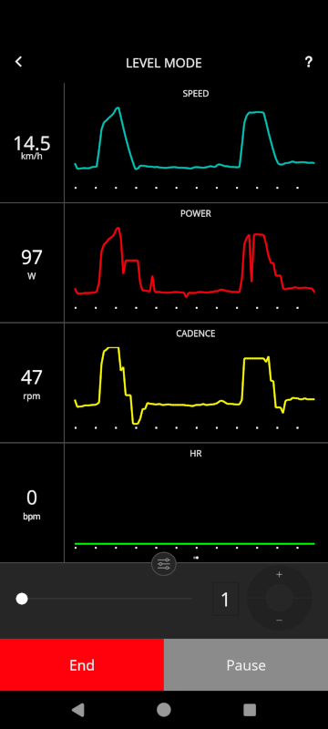

without Power Meter Link: Power values increase / decrease immediatly after change of cadence / speed. (Resistance is constantly set to 1)

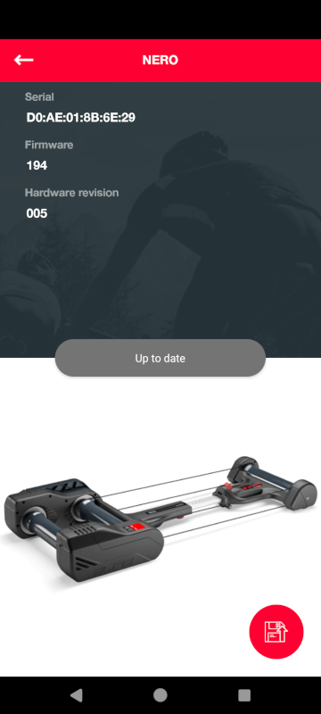

Firmware:

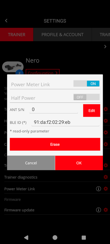

I disabled PML and connected the power sensor via Bluetooth in the My E-Training settings.

I can understand the described reasons for a delay of up to 3 seconds.
However, the power values I have shown cannot be explained by ANT+ transmission problems for two reasons:
1. I have additionally performed a test with PML over Bluetooth and observe comparable power values as before with PML over ANT+
2. I have tried to pedal power values according to a step function. This is also shown by the speed curve and cadence curve (constant resistance). According to my understanding, transmission errors would lead to a delayed step function. However, the displayed power curve shows a step response without significant delay but the power values increase/decrease slowly and continuously almost linearly up/down to the actual value. This indicates to me some filtering of the external power values is performed when using PML.

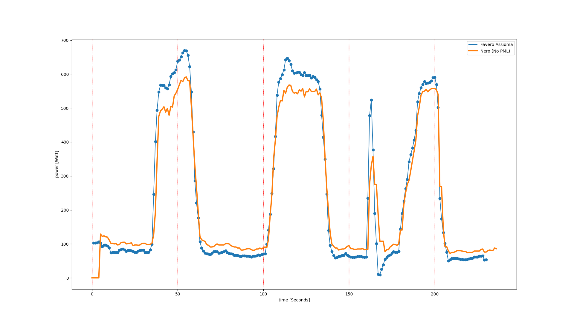

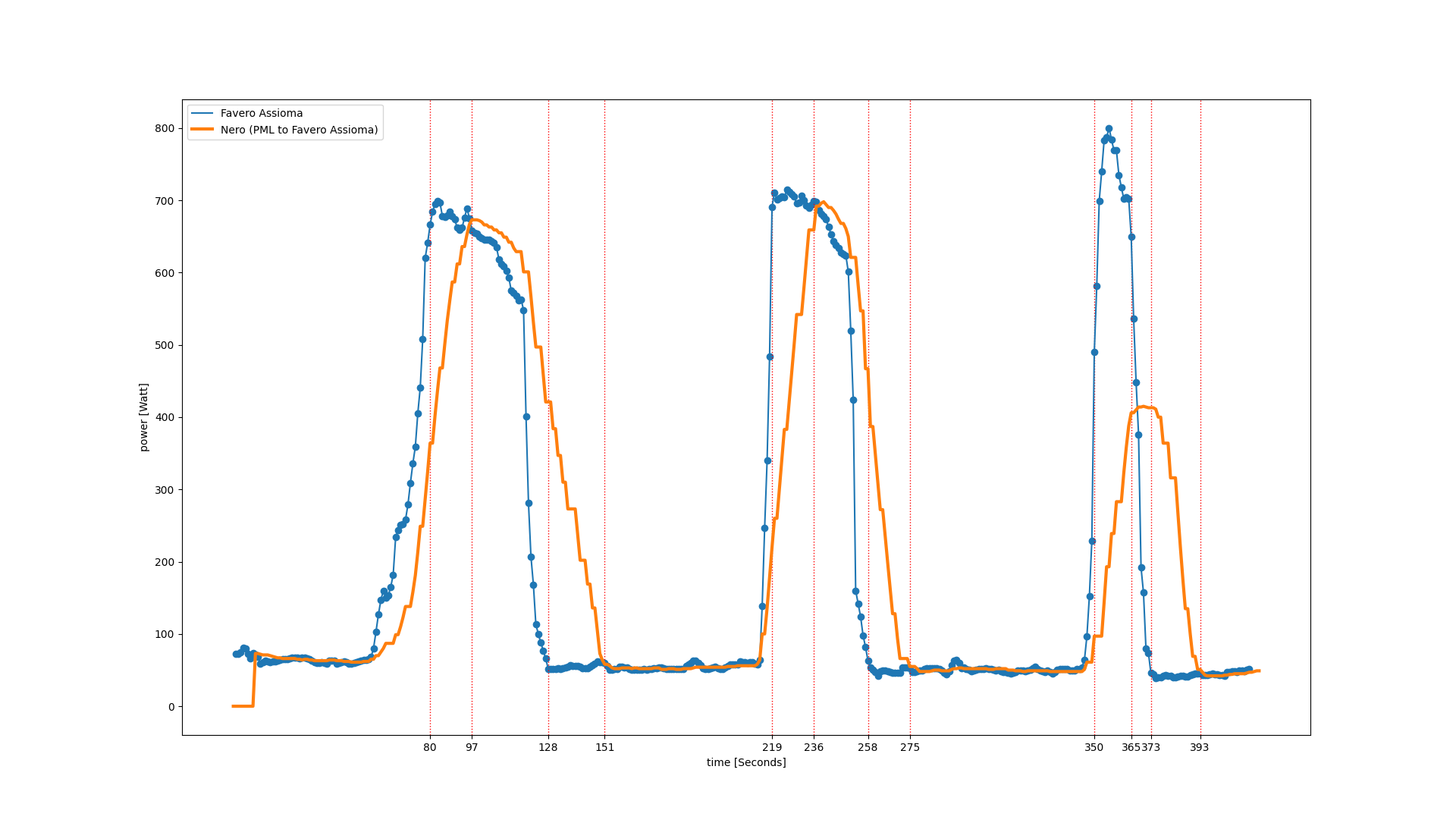

I used the ticket system to ask if the Nero could simply transmit the power values it receives via PML to the connected smartphone. I have attached the following graphics to this ticket, which show the unusability of the Nero for virtual competitions.
Incorrect values without PML:
Delayed / smoothed values with PML:
Elite replied that it was not technically possible to reduce the delay when using PML. Although I asked for an explanation, I was not given one.

As an example, 30-second intervals look like this:
Without PML:
With PML:
