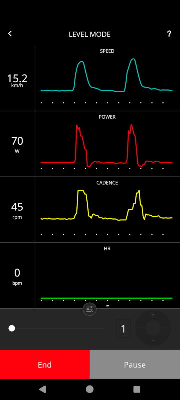

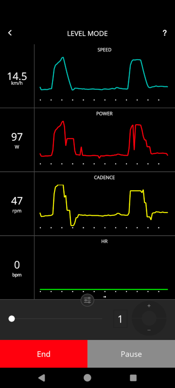

with Power Meter Link: Power values increase / decrease slowly after change of cadence / speed. (Resistance is constantly set to 1)
without Power Meter Link: Power values increase / decrease immediatly after change of cadence / speed. (Resistance is constantly set to 1)

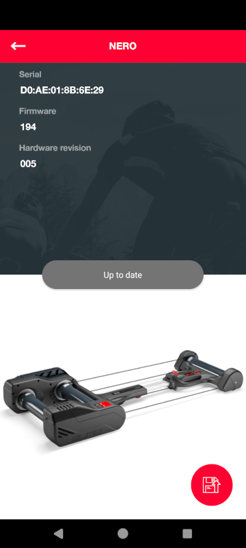

Firmware:

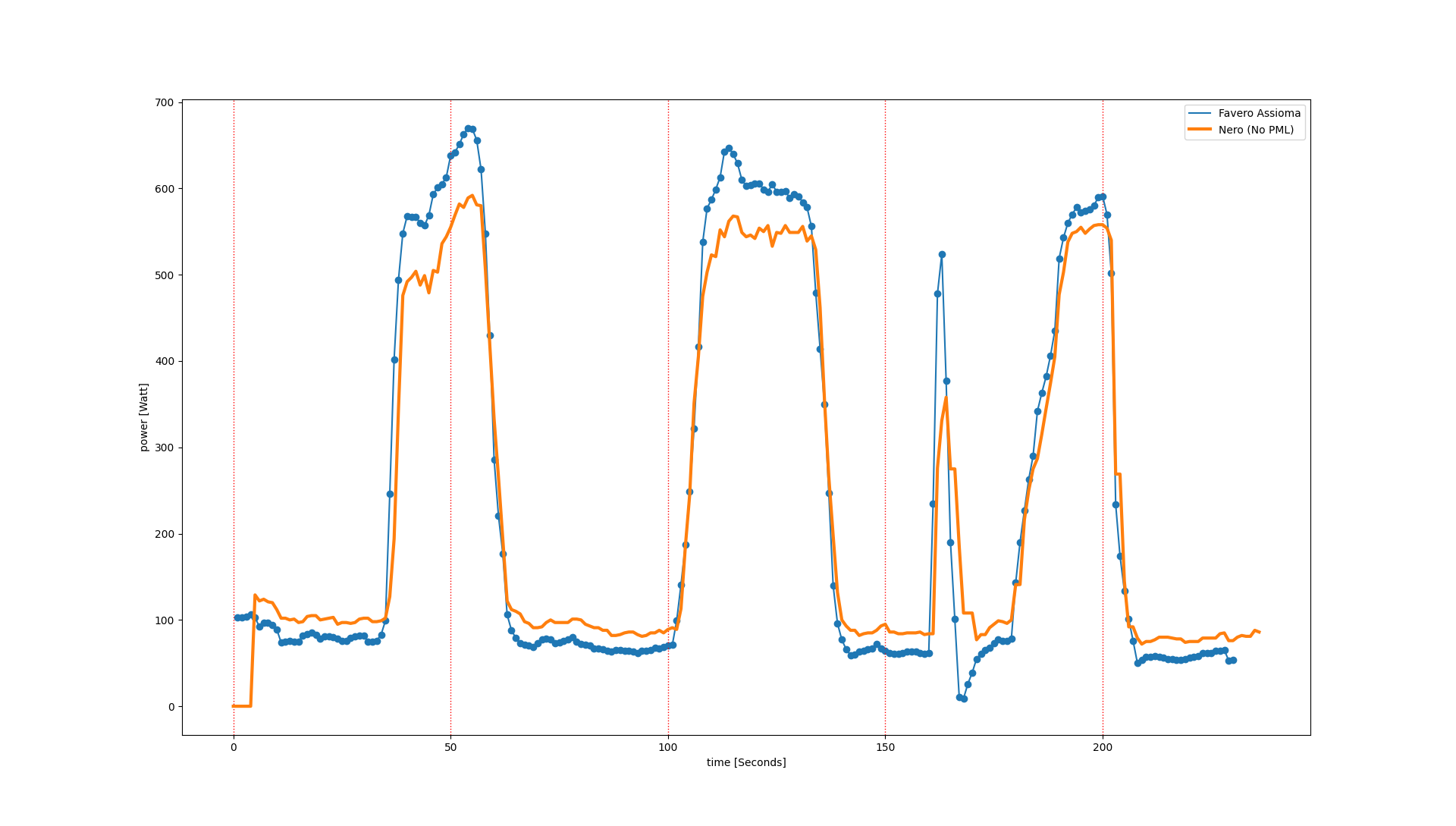

I used the ticket system to ask if the Nero could simply transmit the power values it receives via PML to the connected smartphone. I have attached the following graphics to this ticket, which show the unusability of the Nero for virtual competitions.
Incorrect values without PML:
Delayed / smoothed values with PML:
Elite replied that it was not technically possible to reduce the delay when using PML. Although I asked for an explanation, I was not given one.

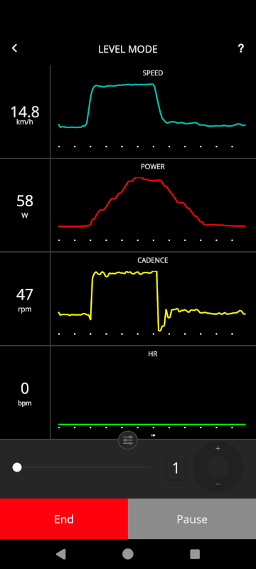

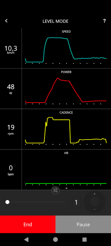

Hi, I know it's an old thread, but I'm having the same problem.
As an example, 30-second intervals look like this:
Without PML:
With PML:
Did you find a solution?
