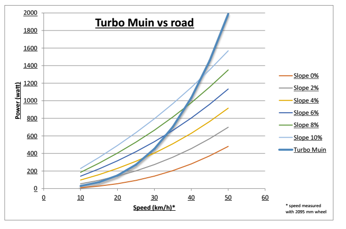

About the speed, it is correct that you have a lower speed than on the road.
Have a look at the power curve of the Turbo Muin below. As you can see, the effort is far higher on the Turbo Muin. This means that with the same power, you'll have a lower speed on the Misuro compared to the speed you'd have outdoor.
I suggest you also to take a look at this document, that explains in details how the Turbo Muin works:
https://drive.google.com/file/d/0By4rZv ... 5JMlk/view
- TMvsROAD.png (52.19 KiB) Viewed 83363 times
