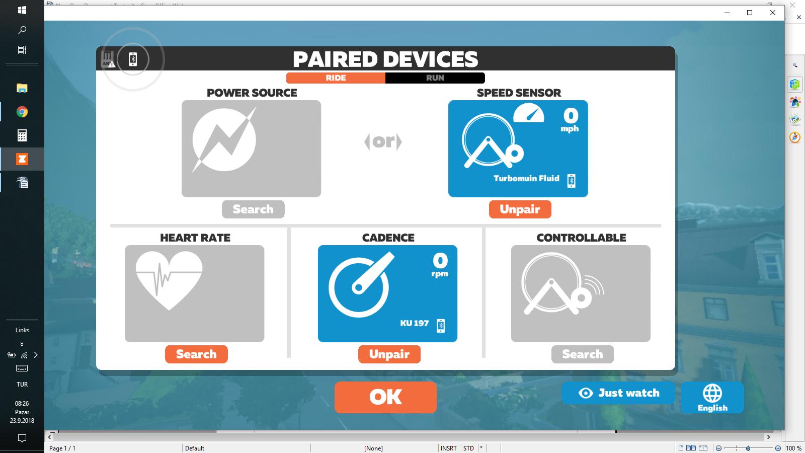

hi,
I tryed to connect zwift via zwiftcompanion application. But kura trainer seen on zwift application as cadance sensor or speed sensor. power sourse dosent work.
And when i read the QR code for activade my trainer i have 'invaid QR code' message. I m not sure did i actived my trainer or not.

Postby Elite Admin S » Mon Sep 24, 2018 8:38 am
Unpair the trainer as a speed&cadence sensor and select it ONLY as a power source.
This should solve the problem.

Postby evrim.yigit » Mon Sep 24, 2018 10:08 pm
I borrow and try ant+ doggle. It works perfect. Thank you.
