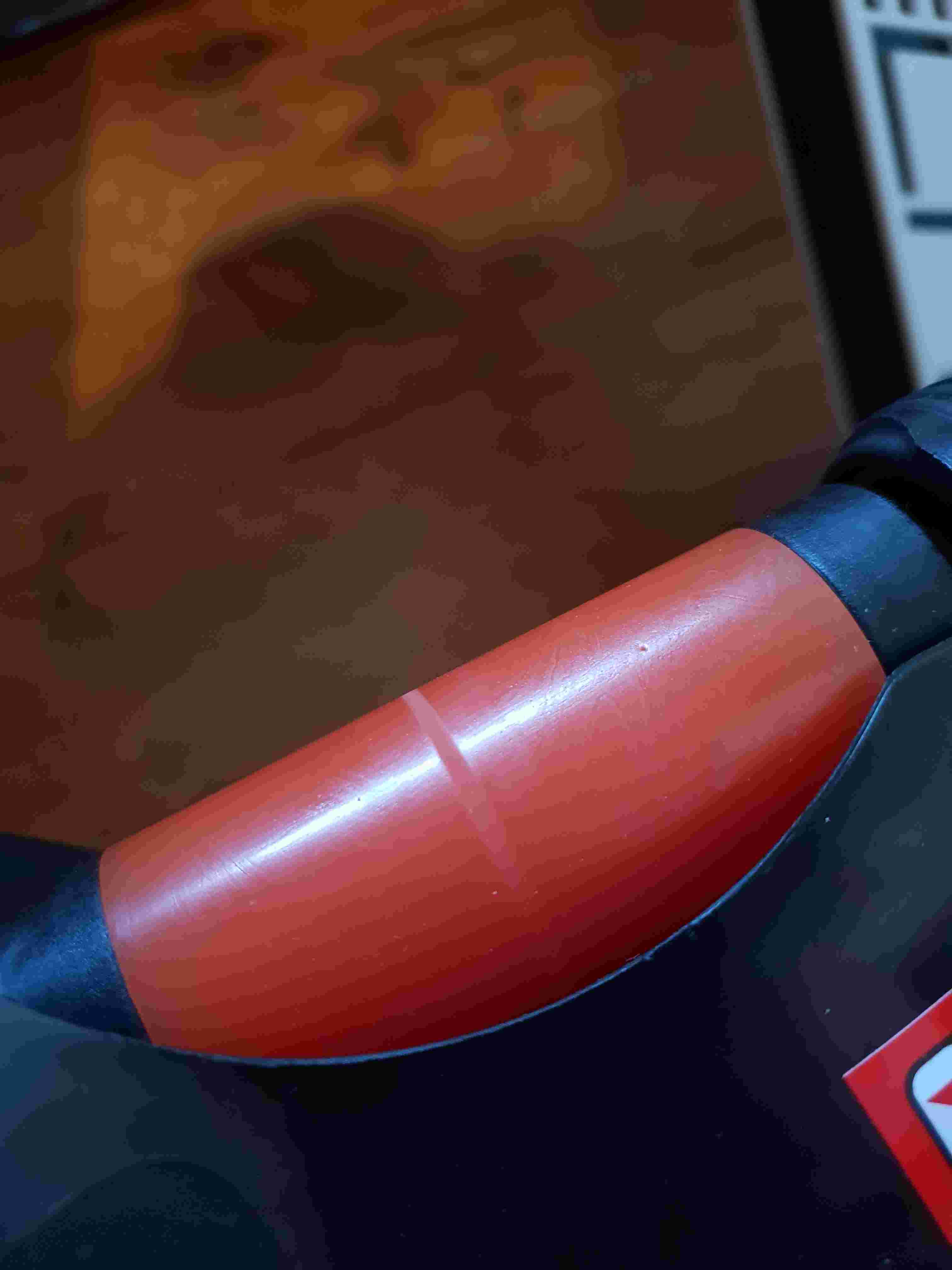

I have the same problem with my EVO. I used a special tire for home-trainer (Decathlon 700x25)
I tried for the first time this morning my new EVO and I observed this (attached picture). Is it normal?
Thank you
Picture of the roller

Hi guys
Novo Smart and Evo have the same frame.
It's very important to mount properly the bike on the trainer. As I wrote you before, you have to do three complete turns of the mob to have a proper contact between the tire and the roller. If you notice a groove on the elastogel roller it means that there's not enough contact (or you braked on the trainer).
The damage is permanent and the elastogel roller cannot be replaced, so be careful.
If the damage is little, you can move a little on one side the unit of resistence to avoid the groove (the hole of the fixing bolt of the trainer are slotted).
