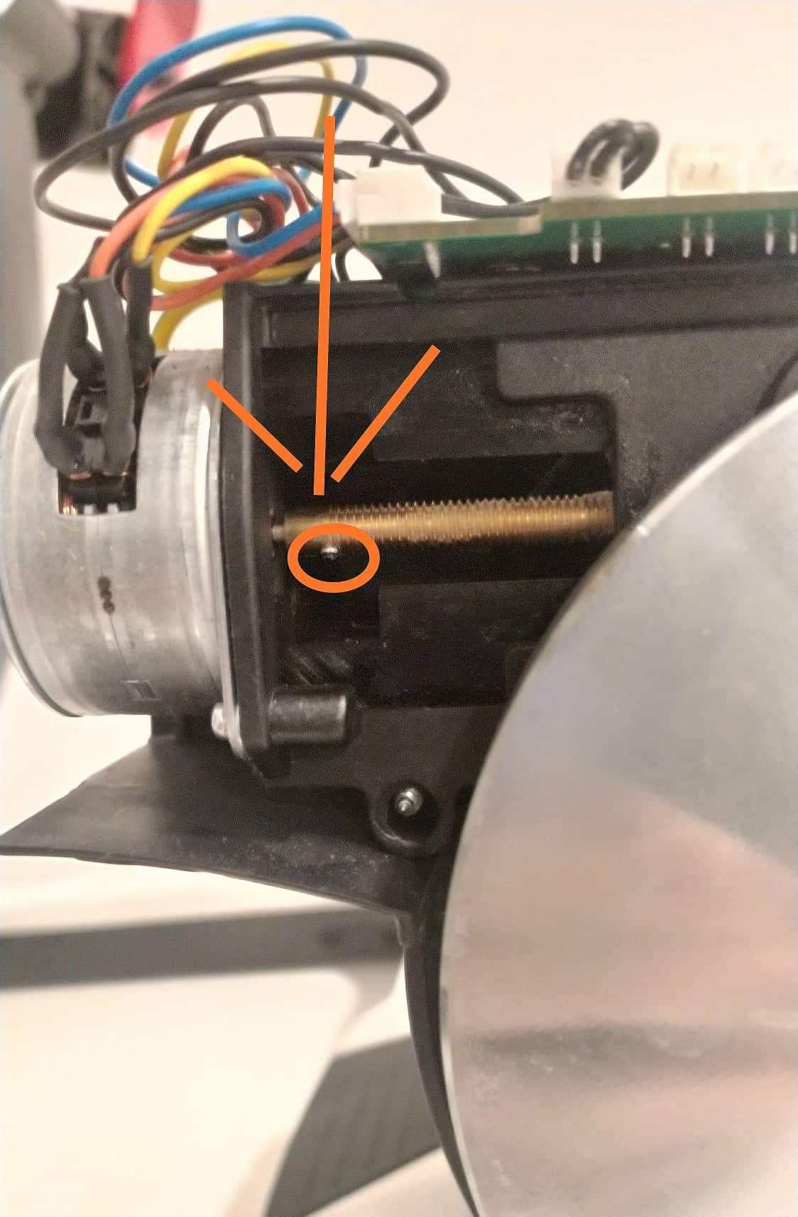

first I unscrew the red top cover and the black side cover. Then, using a small screw on the shaft(golden thing), I turned the shaft(golden thing) down (if you look at the trainer from the back so to the left) by about one turn. I did it with a screwdriver (although it's hard to turn but it works)
and here are the pictures:
https://elitesrl.zendesk.com/hc/en-us/a ... d52f4cbf63
https://drive.google.com/file/d/0B2n_HS ... p=drivesdk
use that little screw to turn the golden thing

marek774 wrote:first I unscrew the red top cover and the black side cover. Then, using a small screw on the shaft(golden thing), I turned the shaft(golden thing) down (if you look at the trainer from the back so to the left) by about one turn. I did it with a screwdriver (although it's hard to turn but it works)
Hi there, I also opened up the covers, my screw is facing upwards, not down like in your photo. To take off the flywheel, do I just use a spanner to unbolt? Then after do I just clean up the metal dust and crease the plastic?
Here's a video of it when I plug it in, nothing is moving - is it supposed to look like that? :roll:
