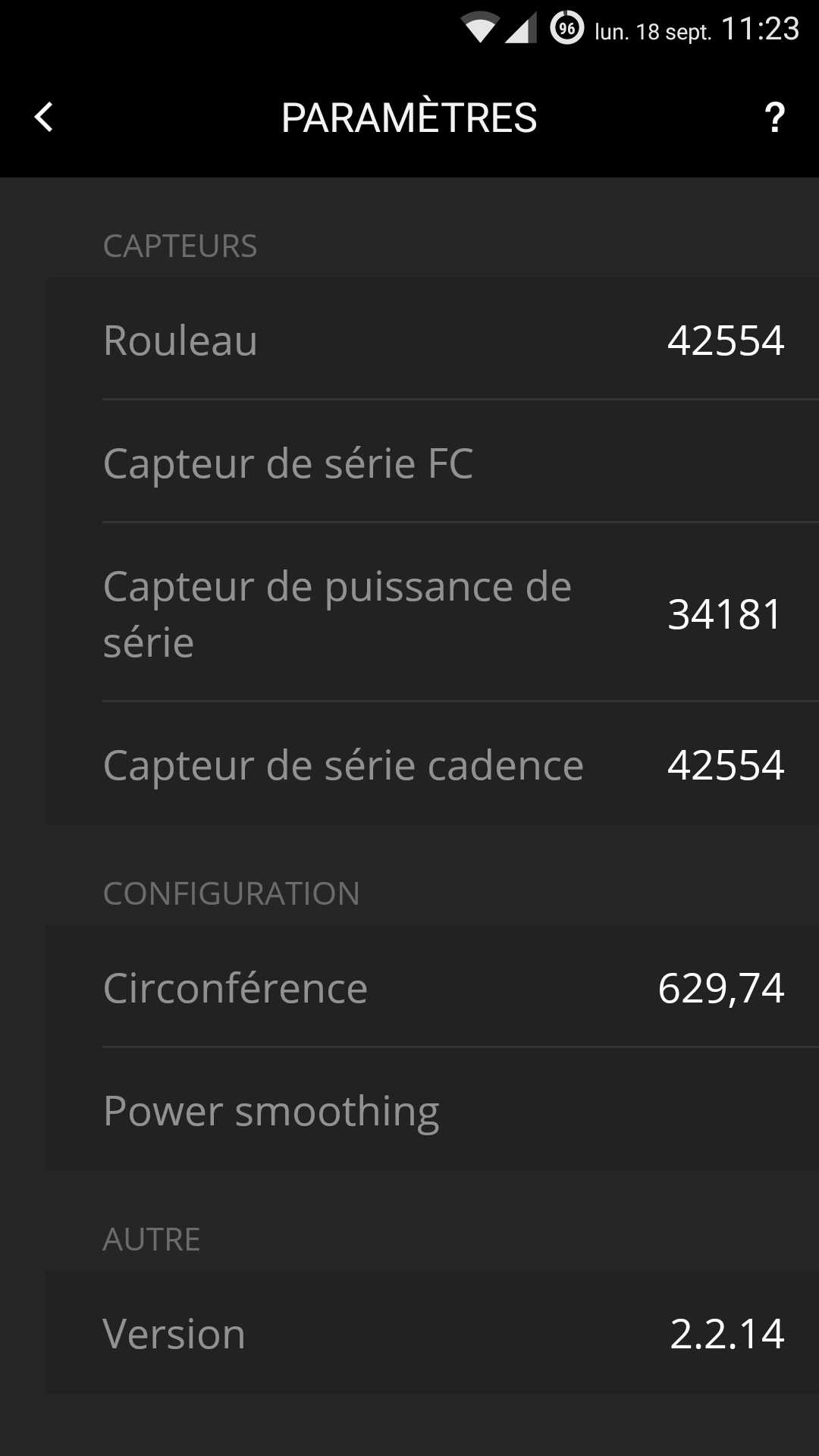

I don't see any calibration option in the advanced configuration screen in My e-training app ? :oops:
Re: Drivo calibration ?
Postby Elite Admin S » Mon Sep 18, 2017 8:31 am
Hi guys
Well, that's strange...
Please open the Parameter - Advanced Settings menu and check if you have this option:
jbroussia
Posts: 22
Joined: Fri Sep 08, 2017 12:38 pm
Postby jbroussia » Mon Sep 18, 2017 11:28 am
This is all I have:
jbroussia
Posts: 22
Postby jbroussia » Mon Sep 18, 2017 11:33 am
PS: what is that number in circumference ??? I set mine to 2160 mm, why does it show 629,74 ??? (it's not the value in feet/inches, not the diameter, ... ?)
