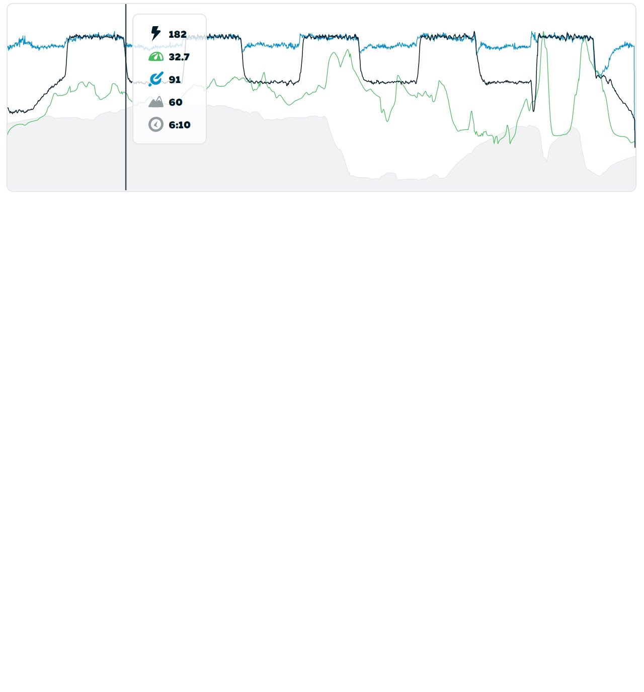

Have you tried ERG sessions in the small chainring?
I have a Drivo Mk1 and was having the same issue with power fluctuating around the required level on ERG workouts. I read on another forum to use the small chainring and this works perfectly. I also changed power smoothing to 10 using the Elite App.
It takes around 10 seconds to reach the level required and holds it there within 2-3 watts as the cadence fluctuates, which is of course realistic as it's impossible to hold the exact same level of watts over an extended period.
I prefer it to ramp over 10 seconds or so to the high watts level on an interval so it's not like hitting a wall.
Added bonus that it levels the amount of wear on the chainrings as people spend most time in the large chainring in real riding.
From a workout I did on Zwift earlier.
