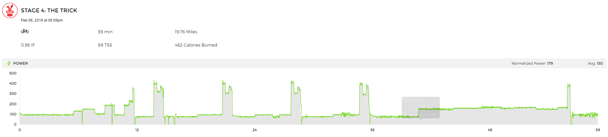

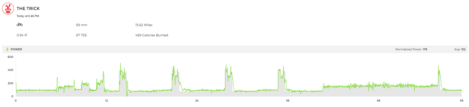

I am having the same issue as the other gentlemen in the posting. I own a first generation Wahoo KICKR and have used it for years. I needed to reduce the noise level of my trainer and purchased the Elite Drivo Giro D'Italia Edition (my favorite race by the way). I've noticed the same behavior of over compensation and under compensation during my training sessions on Sufferfest. After experiencing the same up-down power fluctuations, I used an external cadence sensor to perform a side-by-side comparison of rides. This would take cadence completely out of the picture. I also performed a full calibration and power smoothing test using the app after one of my workouts prior to the test. During the side-by-side comparison, what I found was my suspicion delayed ramp ups and delayed ramp downs and much wider fluctuations of power versus the Wahoo. It is almost as if it is too engineered and measures too much and tries to correct too much. I am attaching images to show the side-by-side. I think the Drivo has the potential to be a great trainer, but this issue is a deal breaker for me and makes me regret I purchased this product. You really need to fix this issue to make this trainer on par with the Wahoo KICKR and Tacx Neo.
Wahoo Capture:
Drivo Capture:
Wahoo Capture:
Drivo Capture:
