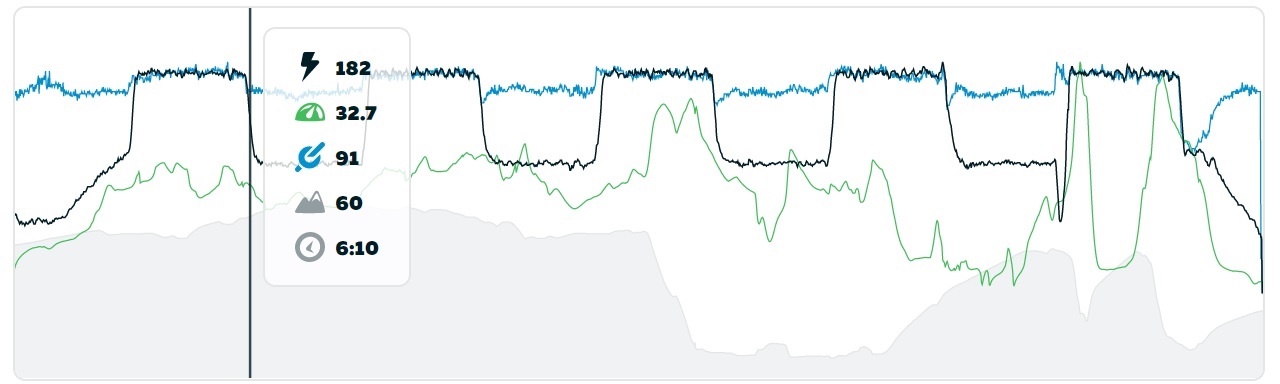

I have a Drivo Mk1 with latest firmware installed. Really happy with it, I'm just having one small issue that I wanted to share and see if anyone had any ideas.
Issue is that in ERG mode, at some point in the 1/2 hour sessions I do on Zwift, the power level drops off like it's disconnected from Zwift. It picks it up pretty quickly and carries on fine. Usually after 20 minutes and always on a low power interval while recovering from an interval. Does the same with ANT+ or Bluetooth connectivity.
Screenshot from a session I did this morning. You can see it holds watts just fine and then just before the final interval it drops off before recovering.
Also speaking to Zwift support who initially recommended trying Bluetooth from the ANT+ I was using, but that doesn't fix it.

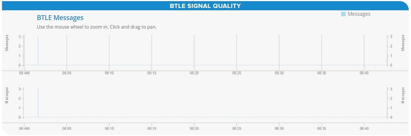

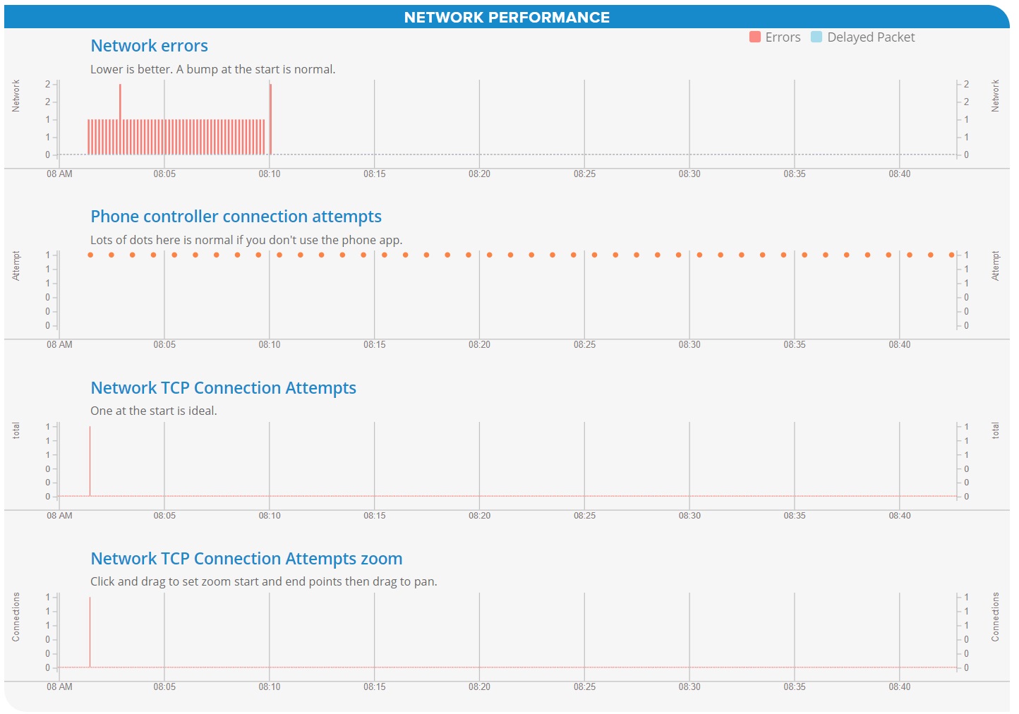

I uploaded the logs to https://zwiftalizer.com and it doesn't show any disconnects happening.
Drivo Network.jpg (72.32 KiB) Viewed 22848 times
Drivo Network 2.jpg (166.67 KiB) Viewed 22848 times

Looking at the first table, did you increase your cadence before the power dropped?
stuart.hendry76
Posts: 6
Joined: Thu Jul 09, 2020 1:57 pm
Re: Temporary disconnect on Zwift ERG
Postby stuart.hendry76 » Tue Dec 08, 2020 3:58 pm
No, I was at a constant cadence before, but as the disconnect occurs and the resistance falls away quickly the cadence inevitably increases. So it's a symptom of the issue, not the cause.
