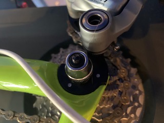

Re: DRIVO 2 Not aligned with frame
some more
- IMG_0700.jpg (25.69 KiB) Viewed 12445 times
- IMG_0699.jpg (28.64 KiB) Viewed 12445 times
- IMG_0630.jpg (80.05 KiB) Viewed 12445 times

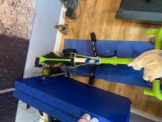

and more
- IMG_0720.jpg (32.44 KiB) Viewed 12445 times
- IMG_0703.jpg (32.49 KiB) Viewed 12445 times
- IMG_0702.jpg (25.03 KiB) Viewed 12445 times
Here you can I have drawn line that show the direction angle of the bike and the Drivo whicj is pointing at an angle to the left (as if you where sat on the bike).
Hope these help clarify the situation
