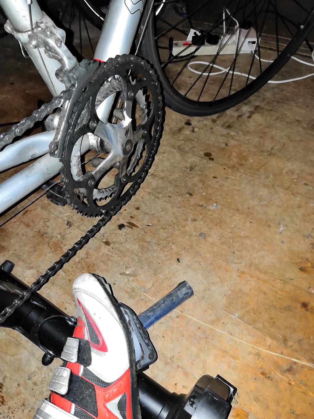

When riding on bluetooth a slope of around 10% is far too easy. When using the Ant+ sensor its the opposite, almost impossible to push the pedals round. So much so my crank has broken!! No point me keeping my drivo any longer. I can't ride my bike until my crank is fixed!
