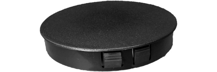

If I can afford it,
For the next version of the drivo, plan a hole for access and lubrication of the belt and which will be far from the electronic card.
Add a cap like this to close it ;)
is it a flat or notched belt?
Re: Terrible sound from my drivo
Postby Elite Admin S » Wed May 30, 2018 8:26 am
Thank you for your suggestion, I'll forward it to the designers.
But consider that this operation usually it is not necessary (it happens only in rare cases).
About the belt, I confirm you that it is a notched belt.
