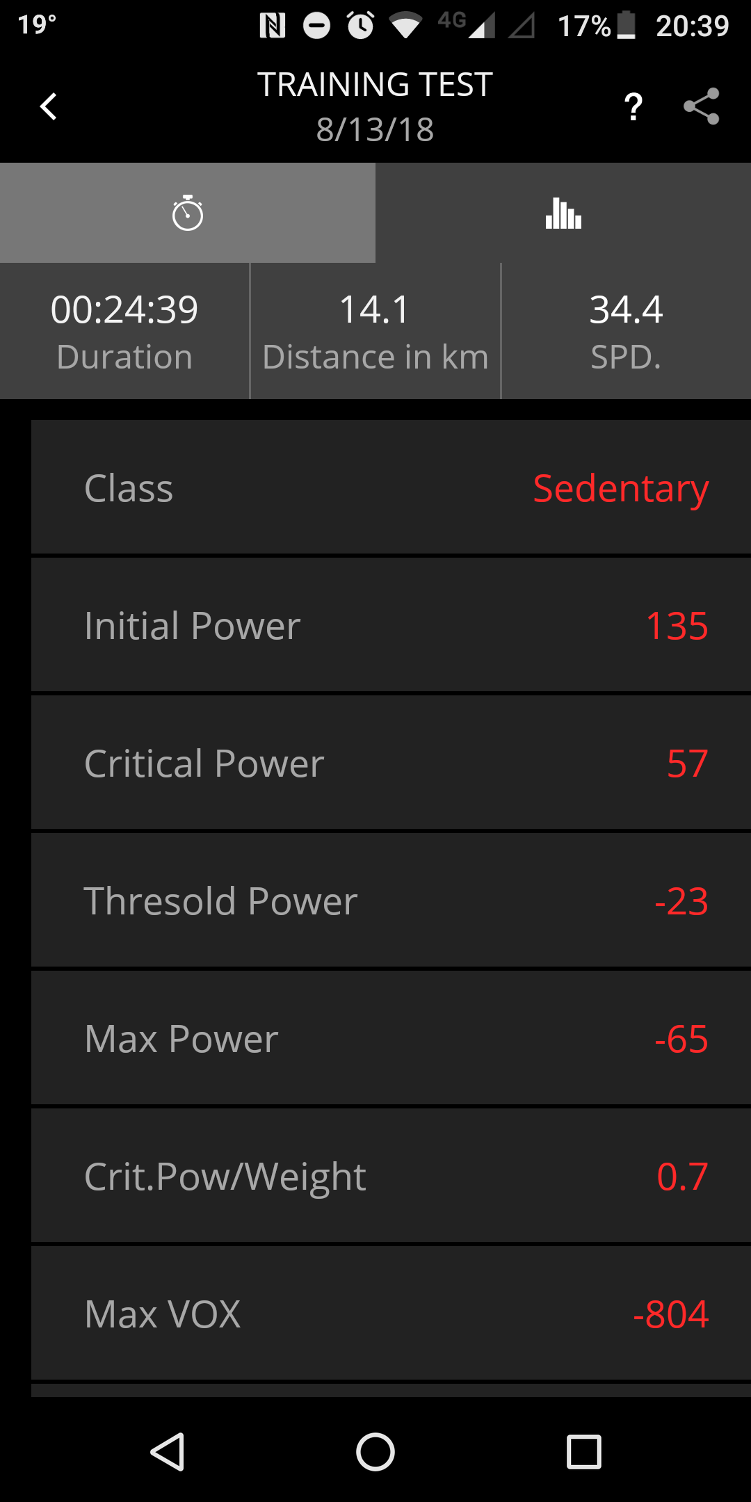

Hi all, just bought a Direto, after a few tests to make sure data is recording I ran the 'Training Test'.
I stopped the test under a minute into the last 10 mins, I could not hold my target HR as the room was too hot and blew up.
The power graph and HR map perfectly to the data I was seeing on the app, but when you look at the numerical test results it shows very low and negative numbers. Even stopping the test early I cannot see why this would happen.
Images of result attached below.
I was also slightly surprised at 182 BPM HR being hit at 240watts. I am just coming back from an injury however so this could be my lack of fitness at the moment. Previous sub-max ramp tests I have gone over 300watts without blowing in the same way. I reserve judgement on the power being out until have run some more tests and recovered some fitness - so long as it is consistent it works for me as a training tool.

If you stop the test before the end, the result will be incorrect.
Please do a complete test and then send me again the result.

Afraid that as the customer care took so long to get back to me (sure it said 48 hours and yet took a full working week), and this post sat for 2 weeks without being approved, I discussed it with the retailer and they gave me a refund in full.
There was no way I could have completed the test as you have designed it, the target HR is just higher than I can achieve and sustain for that long (even with more cooling). Unsure still if you can amend the target HR but then you have not helped me try and sort that here or on email.
