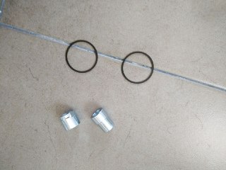

I'm having problems to configure my new Elite Direto. I have setup according to the manual but the chain of the bike makes noise and I cannot use the smallest sprockets of the cassete. When I put the original wheel in the bike, everything works perfectly. I need to say both the bike and the Elite Direto are new (my problem is only with the Direto, like something is not right alighned when I put the bike on the Direto).
Both cassetes (bike and installed on Directo's), are the same (Shimano 105 11v). I'm attaching photos of everything (I can only attach 3 photos but I have photos from the original wheel, bike on the Direto and a photo of the pieces I haven't used). The bike mounts also a q-ring as you can see
Can you help me? I'm a bit worried since I don't know what is happening. Everything seems to be installed fine.

Please check the cassette.
It must be well fixed, with no plays at all. If needed, you can add another spacer.
Let us know it this helped.

I've checked again your photos with our mechanics.
Did you use the spacer provided with the cassette?
If it is so, try to remove it and let me know if the problem is solved.
As you have a 11 speed cassette, theoretically you shouldn't need any spacer (or at least use only ours and not the one provided with the cassette)
