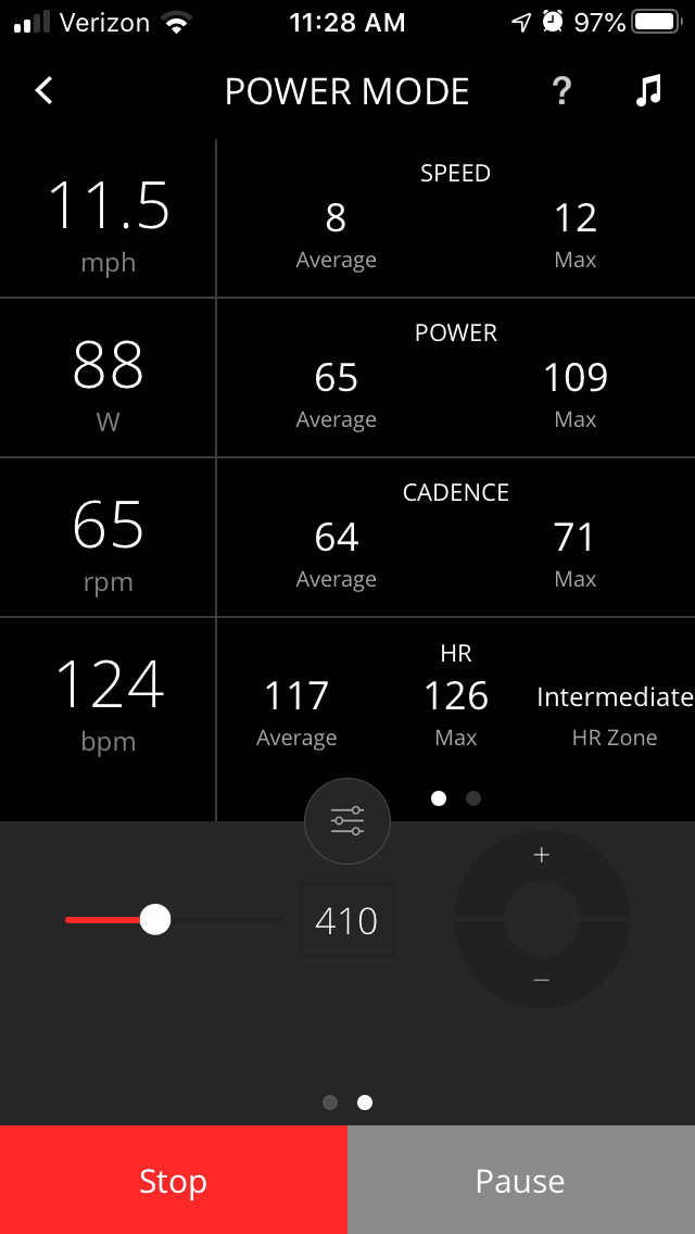

Update : per elite customer support I paired directo with phone myETraining app, calibrated then spun after 10 min warm up in power and level modes. No matter what level or power I choose there is no braking / resistance whatsoever. It used to work but now doesn’t.
How do I diagnose what the problem is and fix it?
Is it mechanical (belt) or firmware? How can you tell?
Thanks in advance!
Scott
