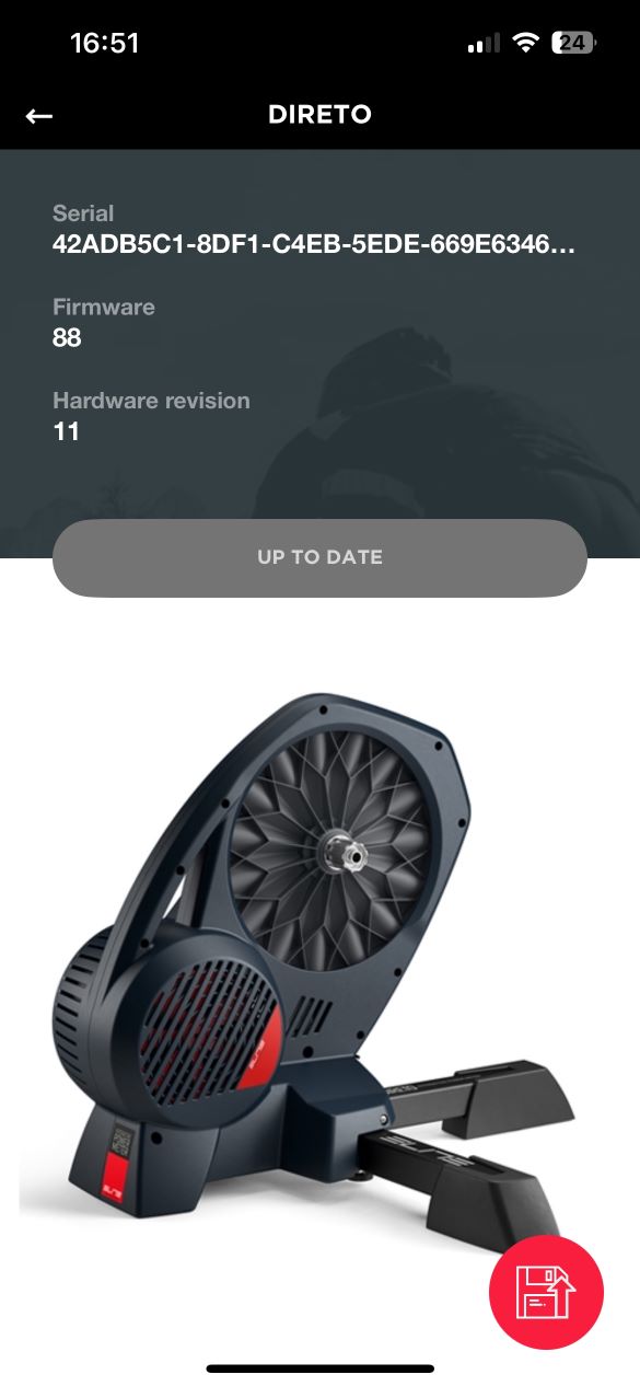

I've had my Direto for several years and have never had to perform a firmware update—until now, that is.
Using the Upgrado app, I have successfully updated to Firmware V88 Hardware Revision 11.
Does anybody actually know what's included with this update? After lots of searching, I can't find a Changelog or any indication of what's been updated.
