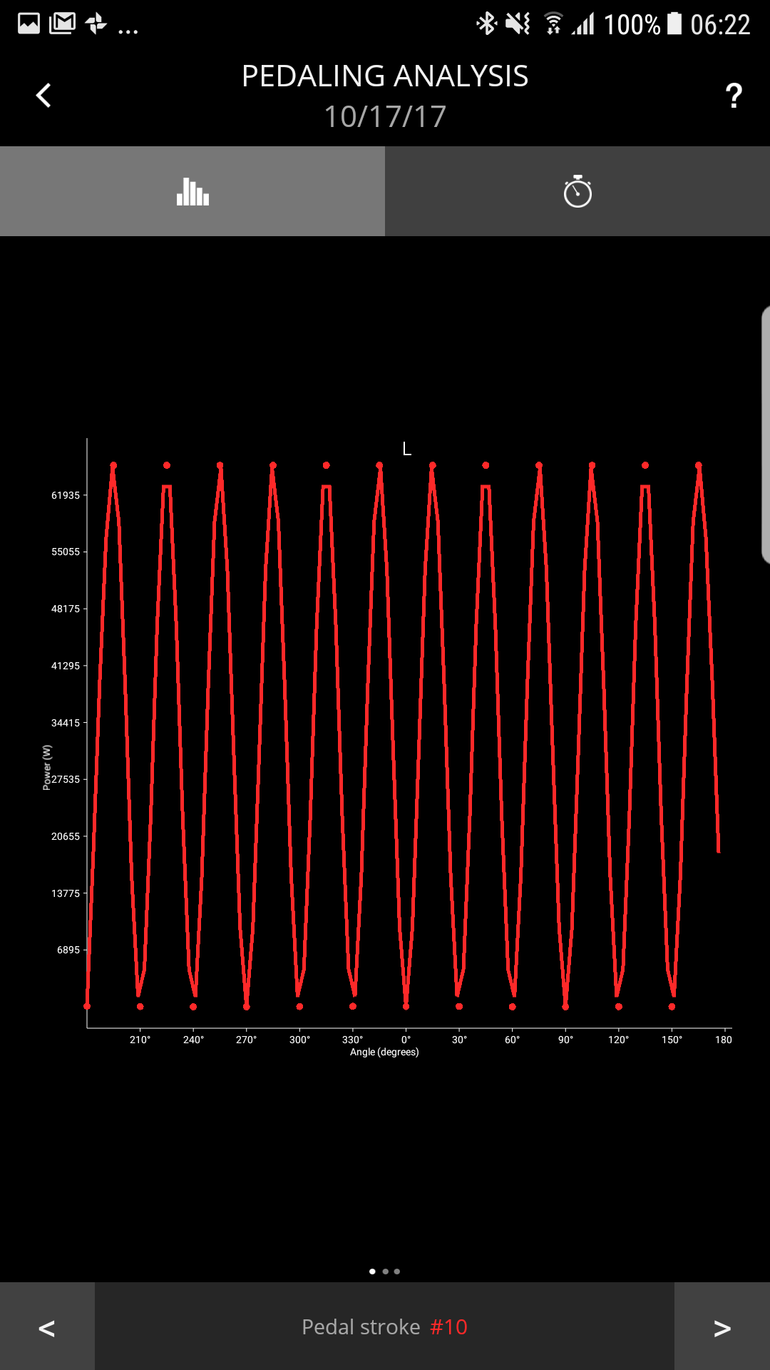

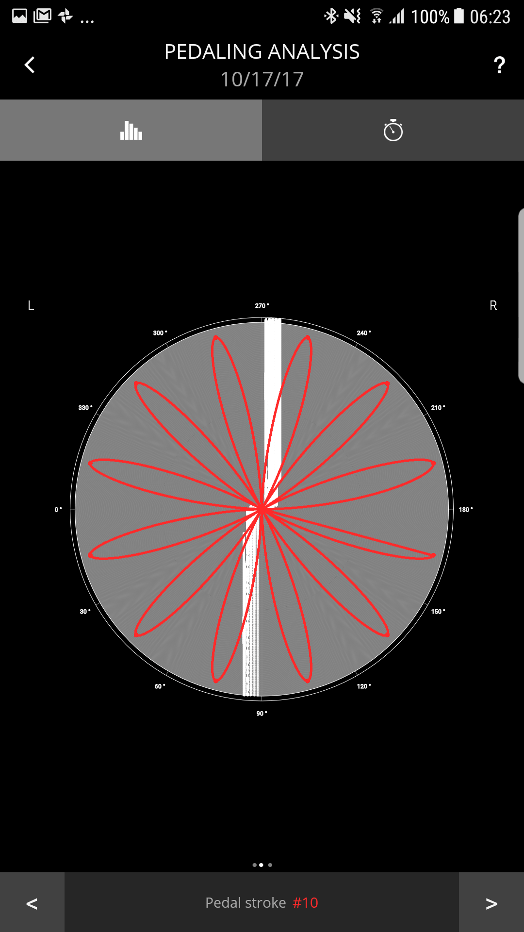

Postby alwyn.jones » Fri Nov 10, 2017 7:38 am
That's the problem it didn't seem to show L and R just one line.
Please see attached photos
Thanks
Re: Pedaling Analysis Direto
Postby Elite Admin S » Thu Nov 23, 2017 10:38 am
Are you sure to have a updated version of the app?
Are you sure to have selected Direto in the configuration?
