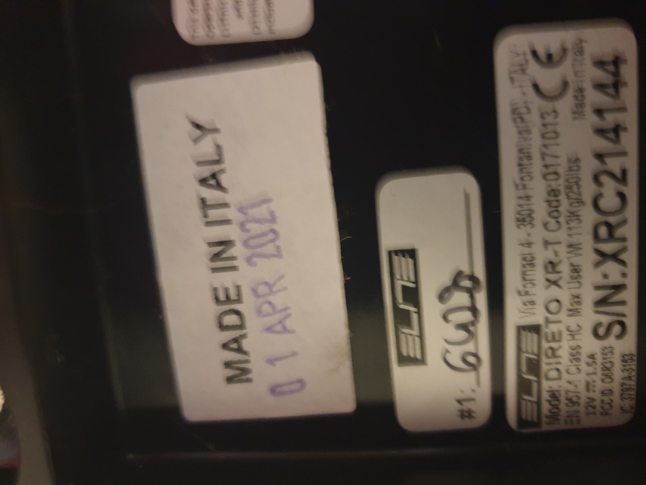

Trying to recalibrate my Direto after changing the belt...can anyone help me decipher this offset code?!!!
- thumbnail_20211217_152629.jpg (123.63 KiB) Viewed 7251 times

That does serm rather unclear. 6428 would be my guess.
However, I might be wrong but I thought that code usually either ended in 0 or 5?
Re: Help deciphering offset code
Yeah i'm starting to think 6428 too....wonder how much a difference it will make?
I confirm you that it is 6428.
If you get an offset different of more than 5 points and at the same time you get any issue (slipping at high slope, sudden drop in power, strange noise) then it may be necessary to tighten the belt. But in this case, please contact the support before doing it (the guys there will give you proper instructions)
