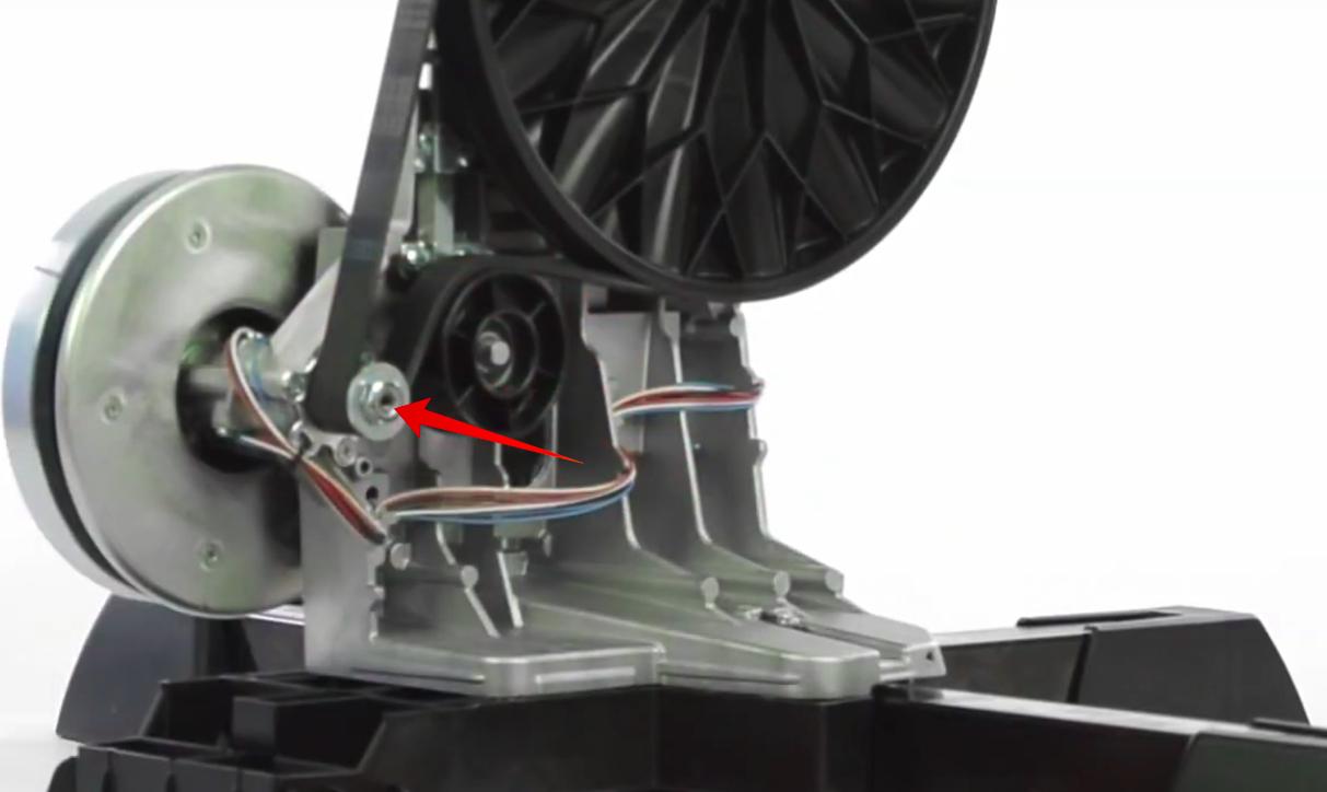

On my Direto X was this screw not 100% tightened.
(I could move the washer behind with hand).
After tightening, no noise anymore.

I had a knocking sound in my Direto X which also very slightly fed back through the cranks/pedals. It was a higher frequency knock than some of the others people have posted videos of. It also got progressively worse and was directly related to cadence.
I contacted Elite support with description and video and received a response within a few working days with a link to this repair video: https://elitesrl.zendesk.com/hc/en-us/a ... rce=search
The video essentially removes the pulley wheel and gets you to clean it, the pulley shaft and all the other washers and bits, and put it all back together. In doing that, all the dust and general gunk build up is removed which seems was the cause of the issue as the knocking has now gone. No new parts or bearings needed. Also gave it a good clean as a fair amount of dust works it's way in. The trainer was around 2.5 years old with circa 3000km on the clock from new.
Hope that provides a little extra background for others with similar issues.
