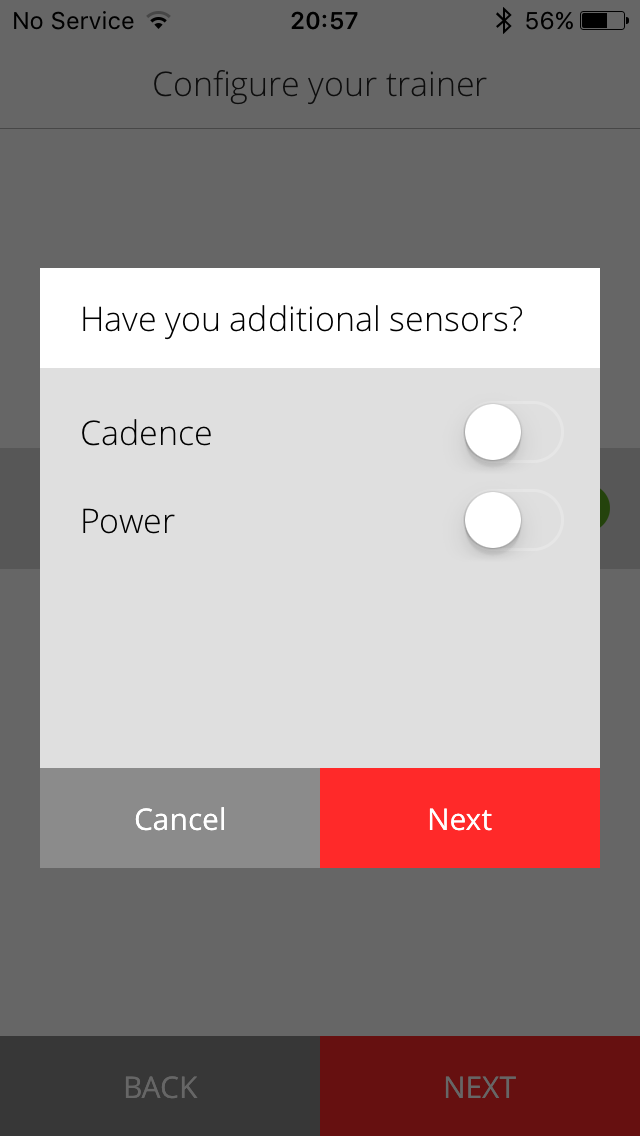

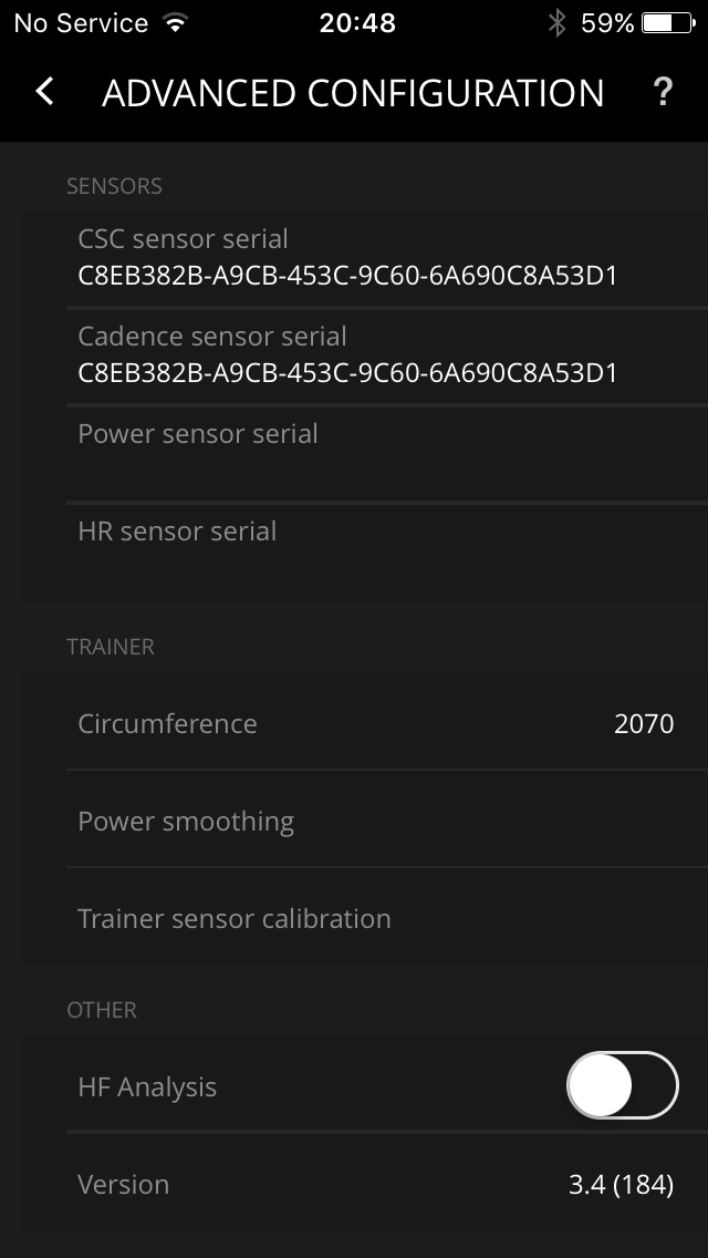

Hello, I'm hoping someone can help. When configuring my Direto time should I select both cadence and power on the menu option (see attachment). When I do select both, it picks up the cadence sensor fine but cannot find the power sensor (see attachment).
Am I doing something wrong here?

You have to select them only if you want to use external cadence or power sensors.
Otherwise, you have to leave them on "no" (the app will then receive the power and cadence value from Direto)

Can you advise why the system is picking up a cadence sensor then when I don't have anything external running/attached?
