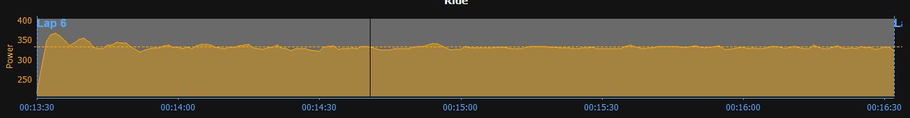

Chart 1: Zoom of 3 min interval with 333w from GoldenCheetah (lap 6 from picture below)

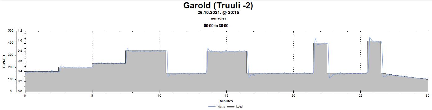

Chart 2: 30 min training with PerfPro Studio Truuli -2. Intervals was 3m@336w, 3min@333w, 1min@400w, 1min@430w

nenadjev wrote:nenadjev wrote:adam.kapala wrote:Am I the only one who finds cadence sensor readings more than unreliable? I've just took GOAT session in The Sufferfest and to my surprise power targets were much overshoot at the very beginning (like 380W instead of 330W) or after few seconds it was impossible to reach power targets (close to given cadence max power was sth like 270-280 instead of 330). During recovery intervals app was showing cadence like 44-49, when I've felt like it was 80-90 and the target was 90 — power target of course were impossible to meet. Afer stopping and pedalling again sensor seemed to be adding additional 40 rpm in a magical way. Throughout whole workout neither power nor cadence targets were even approachable. Frankly speaking my old other trainer — tacx flow delivers better experience when data reliability are considered. Also in my view problem was more vivid during bluetooth connection than ant+ (I've switched after first interval). Next time I'll try with independent cadence sensor and see it it helps. Using just normal (not ERG mode) everything seems to be working just fine.
I've just bought Direto XR and I have similar problem with power when I step into interval, targets are much overshoot at the very beginning of interval maybe 20% or more than target. Did you solve it?
@Elite Admin S
Definitely I have problem with power when I step into interval with large power difference. During the first effort of 90 sec or more the Direto XR deviated from the target by 20-30%!
On the other hand long intervals and intervals with a small difference in strength are very stable and very smooth.
I am using Direto with PerfPro Studio.
Please see images below. First two images are training with Direto XT and third is training with Flux S, both with PerfPro Studio. I sold my old Flux S and bought a brand new Direto XRT and I was think it will be an improvement and that I am taking a step forward, but now I am confused.
