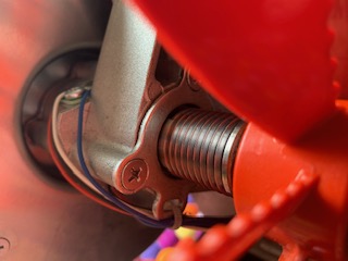

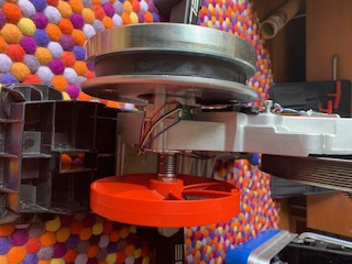

1st gen Direto been working great for 2 years. Now, horrible noises when I pedal and power readings all over the place, this started to happen after belt tightening and calibration. belt is in perfect condition and black roller is fine. There is however a lot of play in the axle that runs the flywheel and red fan. Fan and flywheel move independently a little bit. Any ideas?!! Stuck in isolation with no trainer aaaahhhhrrrrrr.........

Unfortunately the internal shaft is broken
Please refer directly to the shop where you have purchased the trainer and ask a warranty replacement (warranty is 2 years)

Same problem here. Just over 2 year old Drivo 2 (£1200 trainer) has just broken. Opened up to investigate and the axle has snapped!!! Hopefully Elite can offer a solution...?
