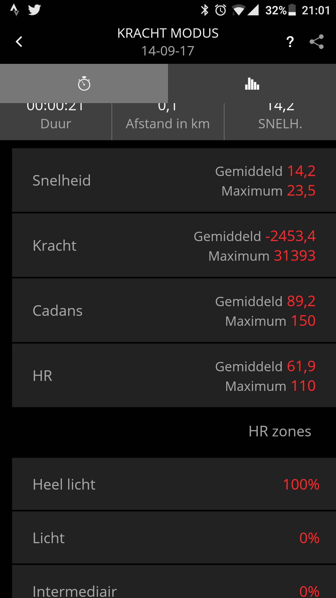

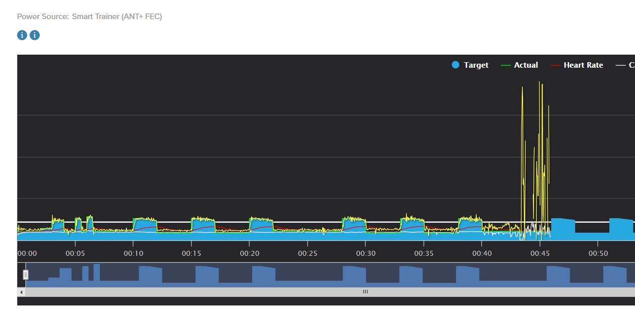

I'm having issues with my elite direto. During a trainerroad workout suddenly my power readins showed +1500 watts. So I tried todo trainer calibration through the MYETraining Android app but this failed several times. Tried to disconnect the power cord and tried again. Even used it on my old android phone. Same result. Failed to calibrate. When I tried the training inside the app I also got some very high +30000 and even below 0 readings. Please help
