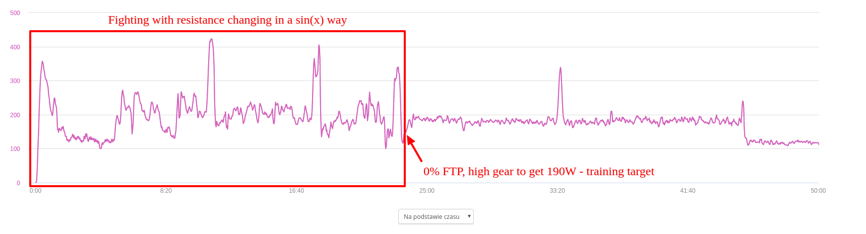

Starting from a couple of days I'm experiencing some serious problems with my Direto X.
When I'm using the Elite App training in the "Level Mode", I'm changing the level setting from 1-16 and there's no difference in resistance - it behaves quite "flat".
On the other hand I'm using Training Peaks to structure my biking workouts and then these are pulled into Rouvy which controls the trainer load - adjusts the resistance so that I generate the right number of FTP% Watts. Once I start the workout even on warm-up (45% FTP) - this should be around 112W - the trainer starts to generate a very high resistance which is putting me into over 320W immediately. Then it shifts the resistance up and down, seeking for the right value. It feels like the resistance changes in a sine-wave manner, high and load are periodically changing within a short period of time.
The image below depicts an example workout. At the 20 minute mark I decided to drop down the "target" FTP to 0% which made the trainer to go completely flat, and then I shifted gears to generate the desired 190W which was my training target.
I've tested this with my iPhone 6s and iPad Air 2 - in case of both devices this behaves exactly the same.
My theory here is that there's some problem with controlling the resistance of the trainer - Elite App fails to set the resistance based on the level from 1-16. Other apps like Rouvy attempt to set the resistance to fit the training targets, but since the functionality is broken, they end up in that "range seeking" behavior to which the trainer responds by setting too high or too low resistance.

grisha87 wrote:Hey!
