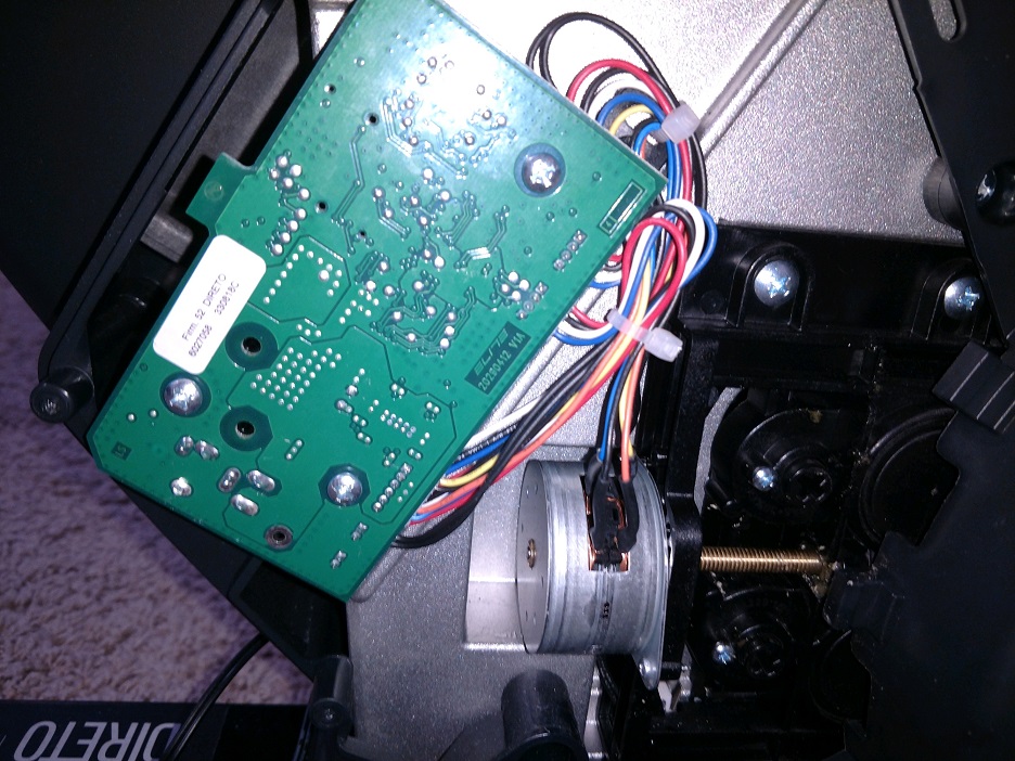

Response from ELITE srl was to pull the four screws off of the plastic panel that covers the circuit board. This being on the non-drive side of the trainer. Plastic cover comes off easily and then you will see access to circuit board and small resistance adjustment motor. Unplug power cord. Then plug in power cord while watching to see if the motor adjustment bolt moves, which it should automatically every time the trainer is powered up. When the bolt rotates it changes the resistance up or down. In my case the bolt and motor didn't kick on.
If the motor doesn't kick on, they suggest manually rotating the bolt while trainer is unplugged. Then, after rotating bolt, plugging in trainer to see if this process re-sets the motor. In my case the motor is still not functioning. ELITE srl requested a video of this process of the motor not working. I sent it and am hoping for a quick remedy! It's sounding like the process isn't going to be a speedy one. Hope this helps some of you out. I'll let you know the outcome. It looks like there are a lot of resistance ERG issues occurring with the Direto trainers. Hopefully ELITE's 2-year warranty on covers this type of defective problem.
- Direto computer board and resistance motor.jpg (244.67 KiB) Viewed 8663 times
