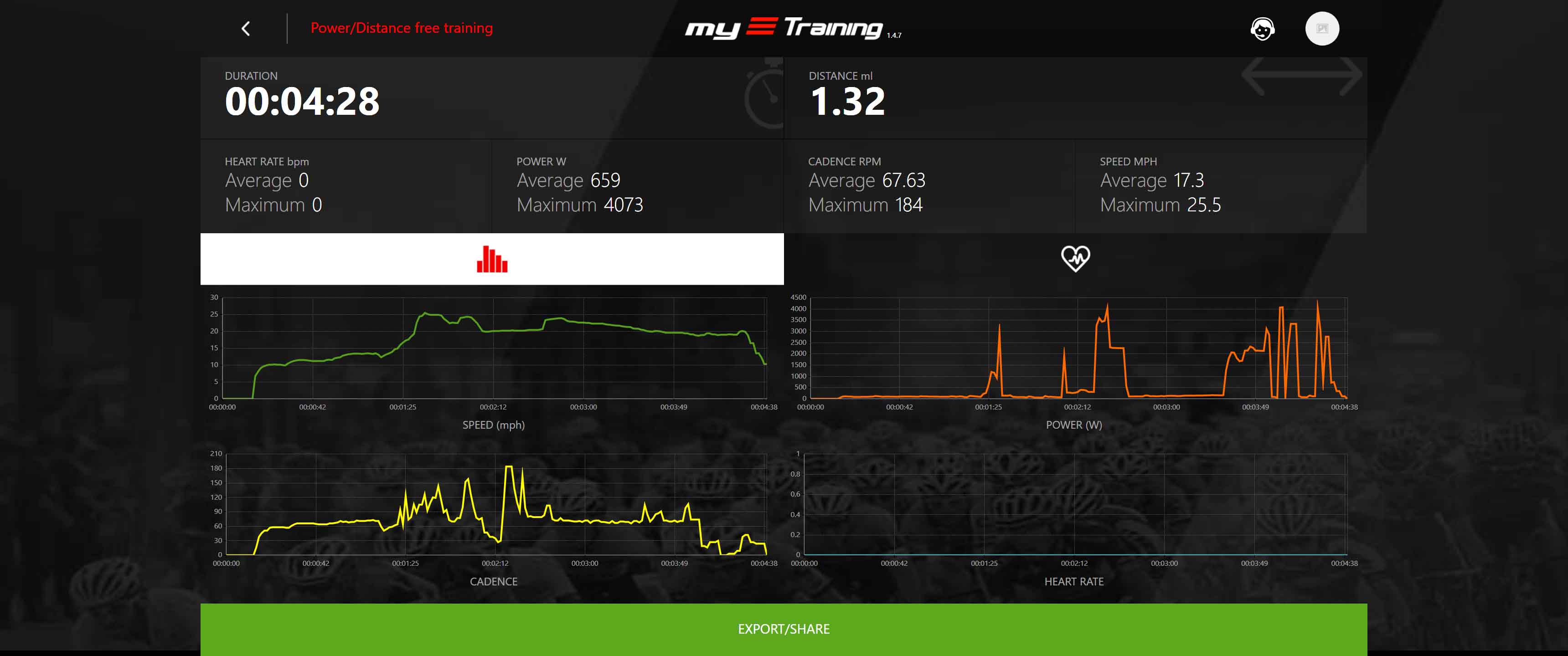

Hi all, I last used my Direto last April. No issues at all. Weather got better so I left it in the corner of my bedroom and haven't used it since, until today.
I connected it to Zwift and started training and all appeared normal at cruising speeds of under 20mph. But when I'm in a big gear pushing a high speed, the power spikes to well over 2000W. Zwift actually warned me that my equipment isn't set up correctly.
I've tried to calibrate it using the phone app, but that hasn't changed anything. The resistance works fine.
Any clues?
Re: Direto giving very high power readings
Posted: Wed Jan 23, 2019 11:37 am
by peowpeowpeowlasers
I did a few experiments. Tried it on the windows myEtraining application, with a bluetooth connection, and an ant+ connection. And I tried it using the mobile phone app too, over bluetooth, just to rule out any problems with my Windows PC.
At about 18-20.5 mph the power meter goes crazy, spiking to up to 4000W. Above and below those speeds it seems fine. So the trainer looks to be faulty.
How do I go about returning it? And considering the weight, postage will be very expensive. Will Elite recompense me for this?

Quick update, I contacted the retailer who asked me first to speak to Elite to see if they knew what the problem is. Elite suggest it's a mechanical fault, so the retailer is collecting it free of charge to deal with.
