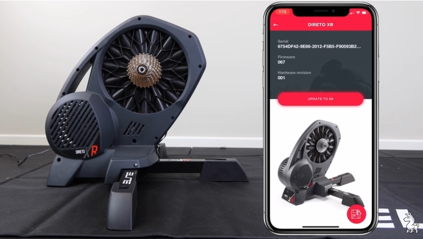

One more possible clue, smartbiketrainers has HW Revision 003, as per screenshot of his upgrado app. Which HW revision you guys have? I have HW Revision 001 on my Direto XR bought 3 weeks ago.

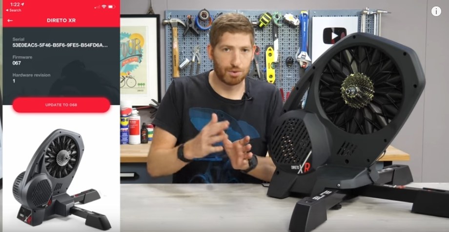

Hmm, good catch, im also on HW version 1. The problem being hardware related would be very bad news, but both DC and Lama are on hardware version 1 (see screenshots), so our units should be able to show the same, good, results.
