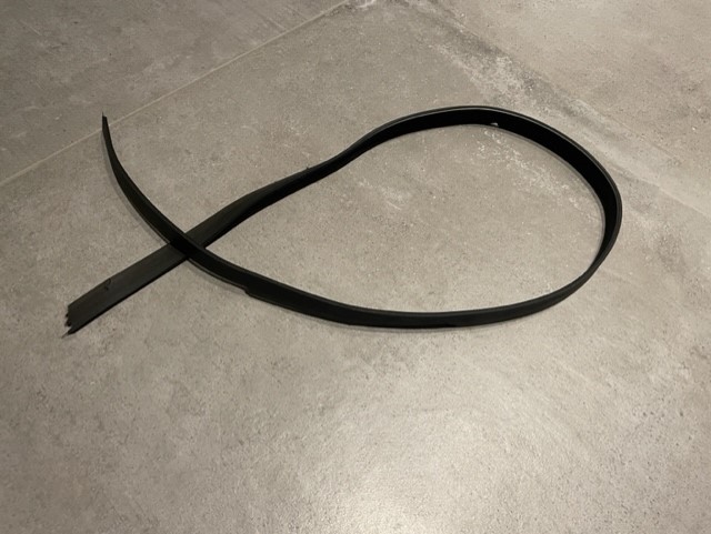

After using my direto for a few years, the belt broke.
I ordered the belt kit with new tension wheel.
I mounted the belt just like the Elite video shows.
I did put the belt to tension just like the video shows.
I calibrated my device.
After riding a few minutes, my belt disconnected and is torn... there goes my 30 euros
old belt
new belt with new tension wheel mounted correctly:
What should i do now? If i buy new belts, will they keep disconnecting and brake?

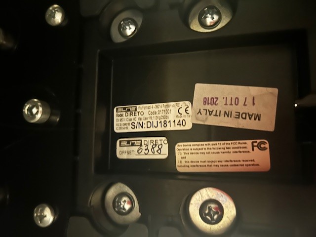

Please give me instructions what I need to do to make the trainer work right. I mean showing all parameters correctly (power, speed, distance). For the first time since purchase, I replaced the belt because it broke. After installation according to your instructions, my offset value is 6510, while the default value is 6388. I sent you photos of the trainer sticker and calibration. Please send me tips/steps that I need to do to update the new offset and the trainer measures power correctly.
- Direto_1.jpg (45.52 KiB) Viewed 34762 times
- Direto_2.png (181.69 KiB) Viewed 34762 times
Re: Elite Direto Belt Tension
It's normal to have an offset variation after replacing the belt.
Please follow the instructions you've received and keep the offset you get as your new reference.
