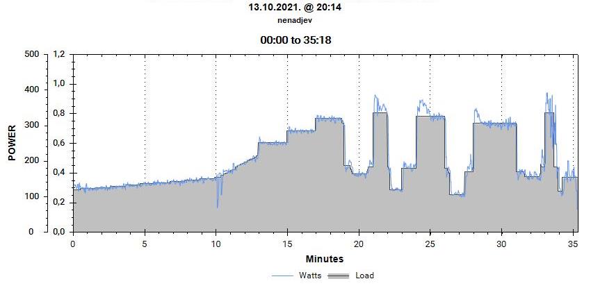

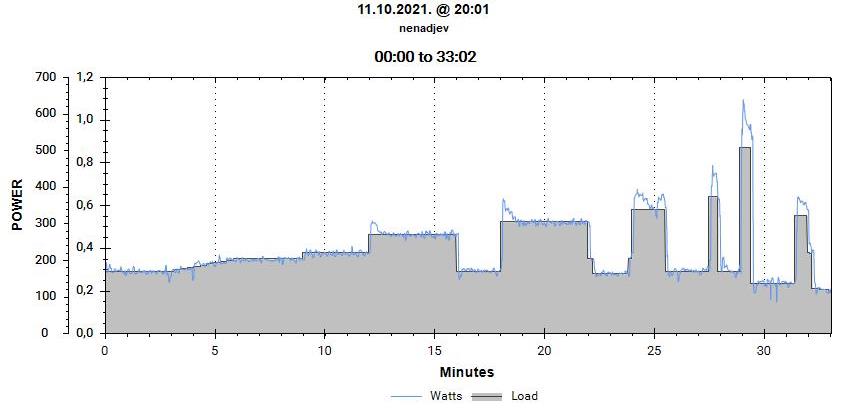

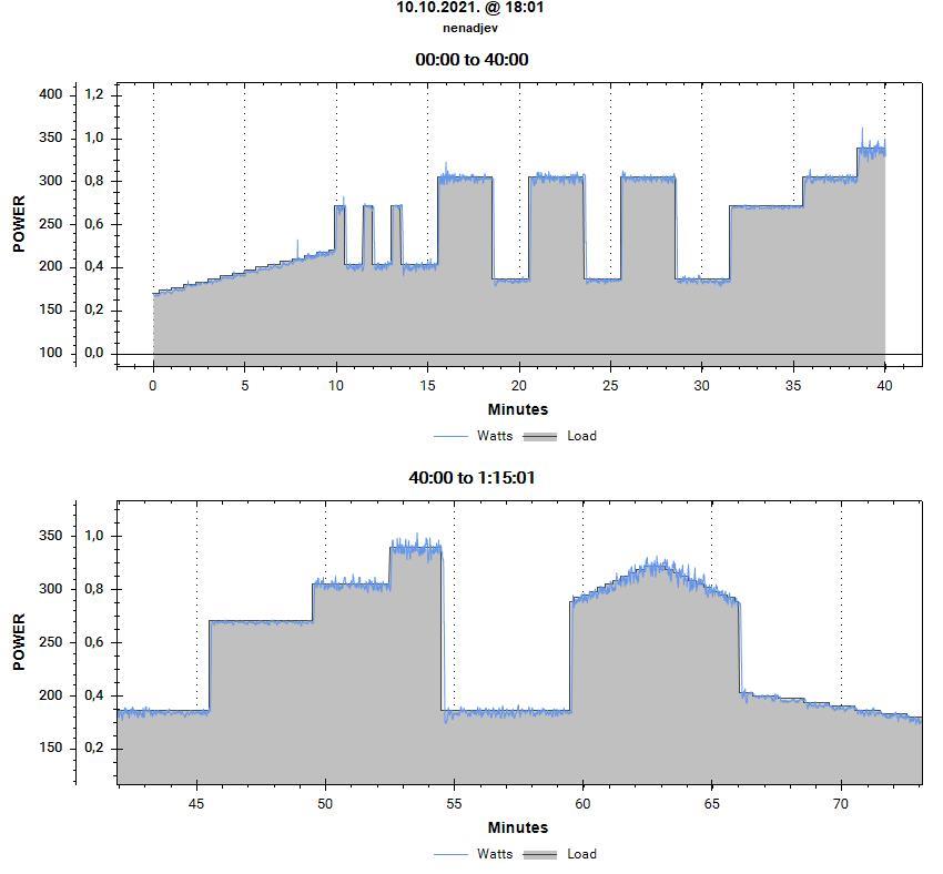

@Elite Admin S
Definitely I have problem with power when I step into interval with large power difference. During the first effort of 90 sec or more the Direto XR deviated from the target by 20-30%!
On the other hand long intervals and intervals with a small difference in strength are very stable and very smooth.
I am using Direto with PerfPro Studio.
Please see images below. First two images are training with Direto XT and third is training with Flux S, both with PerfPro Studio. I sold my old Flux S and bought a brand new Direto XRT and I was think it will be an improvement and that I am taking a step forward, but now I am confused.
Direto XR
13.10.2021. 20-14 - nenadjev.jpg (33.17 KiB) Viewed 56270 times
11.10.2021. 20-01 - nenadjev.jpg (31.43 KiB) Viewed 56270 times
Flux S
10.10.2021. 18-01 - nenadjev.jpg (59.74 KiB) Viewed 56270 times

Postby Elite Admin S » Thu Oct 14, 2021 8:48 am
@nenadjev
I confirm you that the overshooting that appears on large power differences seem abnormal.
But it's necessary to analyze the data to understand what happened exactly (we need to check also speed).
So, please contact our customer care specifying:
- trainer serial number
- latest calibration offset
Here's the contact form:
