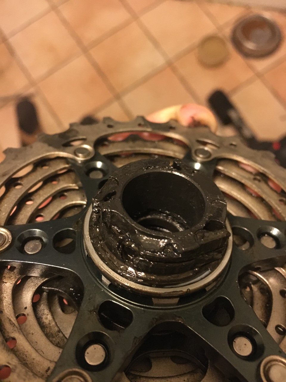

I got a Direto 2 last year in March, after being fine for six months or so it started developing a number of variant issues, initially it started was making a a strange intermittent popping/clicking noise and this seemed to cause a feeling of slippage/chain jumping see video below.
That then stopped but it started being a nightmare with indexing. On close inspection it turned out that the cassette appeared to be ‘wobbling’ so much through its motion that the chain was skipping between gears. I tried tightening it all up but it seems the freehub has movement and therefore the cassette is wobbling. See video, on inspection part of the freehub seems to be missing a piece, has this sheared off? I assume it is meant to be a full circle and the lack of this piece is meaning it won’t tighten hence the wobble?
Any ideas or help on the noise and the wobble? Does this just need a new freehub or is something else going on here?also shimano compatIble freehubs seem to be impossible to source can you advise.

- 82323EE5-77A2-49ED-85E2-C2E29D45E4A2.jpeg (227.9 KiB) Viewed 6397 times

Re: Direto ii problem
Thanks but it’s not that, I know how to get it on its the actual freehub.
On closer inspection the inside appears to have completely fallen apart/broken into smaller rings and completely lost its integrity, some bits even fell out.
I presume then I do just need a new freehub?
Hi - any thoughts on this further to the above? Do you agree this is an issue with the freehub?
It may be a defect on the toothed ring.
Contact our customer care from this page (select the trainer, then click on the link to open a ticket):
https://support.elite-it.com/
Specify the problem and add the serial number of the trainer on the request
