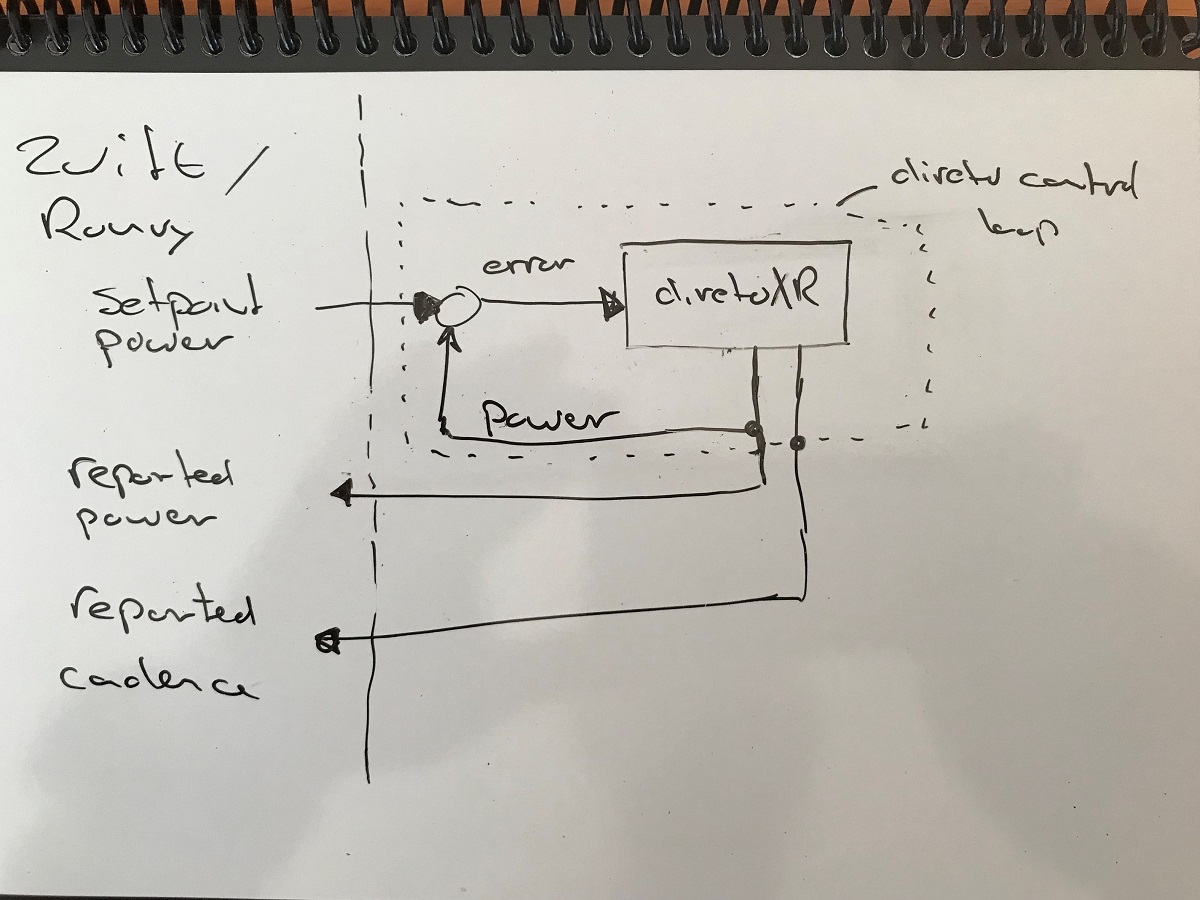

I do not think that in ERG mode the software applications Zwift or Rouvy are actually controlling the trainer. Neither Zwift nor Rouvy nor another application will be the source of the bad behavior in ERG mode. I attached a quick whiteboard sketch to clarify what I mean.
in ERG Zwift and Rouvy only sent a setpoint to the trainer. It asks the trainer to maintain for example 200W. The trainer than adjusts the resistance based on the power it measures internally. So there is a control loop in the trainer that regulates the resistance in such a way that you produce 200W. (I guess it's more complicated than my basis sketch of course).
And it's logical to do it like this. Otherwise, if Zwift or Rouvy would be part of the loop that controls the resistance in ERG it would introduce quite a big and unknown delay in this loop. This because of the Bleutooth/ANT+ transmission lag and your PC or tables processing time. They will vary with each setup of every customer. And if you know a bit about control engineering you know that delays (or death time) in control loops is killing :-)
The trainer also reports back the measured power and cadence. Those are the number Zwift or Rouvey show you on the screen. I expect that the so-called "power smoothing" is an additional filter to that reported power, but it also affects the behavior of the control loop.
I strongly feel that our trainer can be improved by optimizing the control parameters inside the Direto control loop. I also read in other threads (of previous Direto's) that Elite actually gave some users files to update those parameters. I also asked for that, but till today we did not get any respons from Elite admins.
(Me being an engineer as well can even envision a special app to adjust some parameters, that's how I would do it anyway :-) )

Thanks for the nice graph
Yes after second thought I think that my hypothesis was not right, and you're right applications must not be part of the regulation loop.

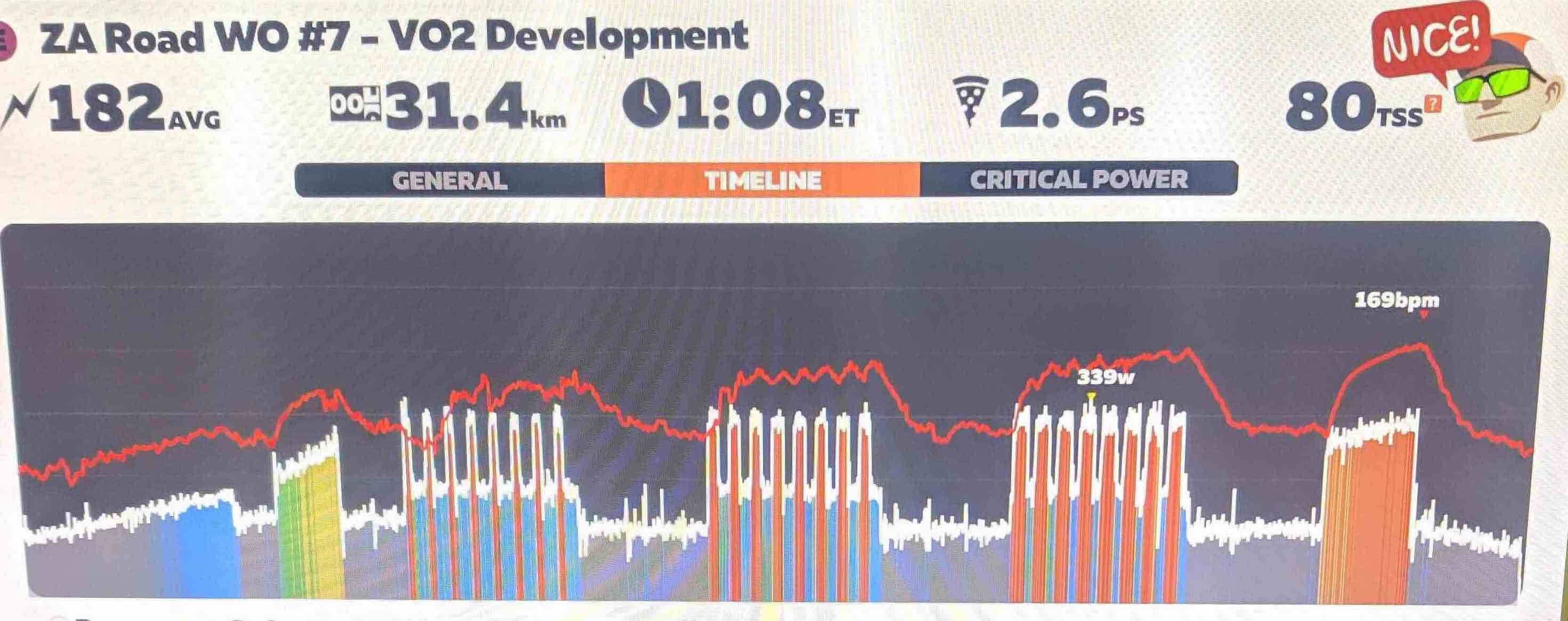

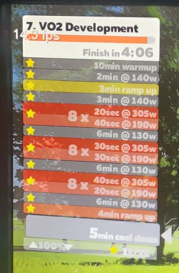

Quick update and a wild theory.
Today for the first time was able to get all the stars in a workout, which impressively was the ZA #7 - VO2 Development. Pretty impressed with the ERG mode performance today, honestly no complaints even about the multiple changes (Smooth set to 2).
The only thing I did since last workout with ERG, despite putting a couple of kms on the trainer (probably around 600km, and I warn no idea if it's related, and not even sure if it's safe, was to perform a calibration with the Allen key adjusting the belt tension so there is no difference between the calibration value and the value written under the trainer.
In my case, the value written under is 6791 and was getting 6787. Following the procedure from Elite on this video, https://www.youtube.com/watch?v=hf0xsbVd91I managed to get it to 6791 (even though after a couple of kms it's back to 6790). Please note that Elite says clearly in the comments that you shouldn't do the procedure!
A couple of screenshots from the workout are attached. Please note that on the 135W sections, I did reach for water, for a banana, etc. But if I want, focusing on the cadence (you must really focus to keep it mega stable), I can keep the power mostly within -5W and +5W from the target, without any huge + or - 20W spikes.
If it matters using the ERG mode on a 36x23 gear.
Maybe the calibration offset is somehow related to the ERG mode performance?
