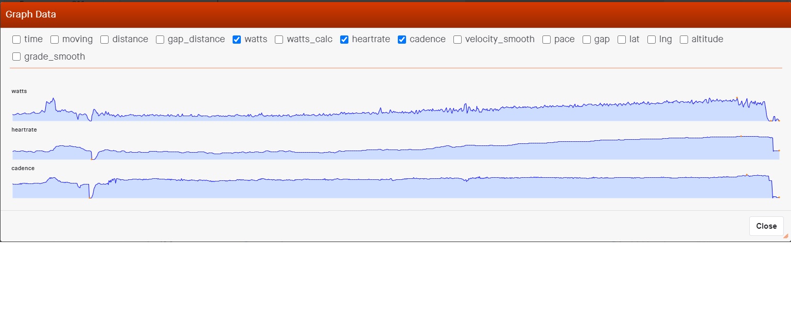

I have attached a graph from my work out. Towards the right hand side you can see that the power drops considerably. My heart rate flattens and starts to lower, but you can also see in the cadence graph,I lifted the rpm, it was from 98 to 105+ to 'chase' the power up. It simply would not increase.
Also, here is another lama post that is worth a look. This probably explains a little more of what is going on with regard to erg mode a little bit more.
I think their are a few issues that Elite need to sort out, like the one that I have posted here. But the reality might be htat the variation is more real than we first assumed.

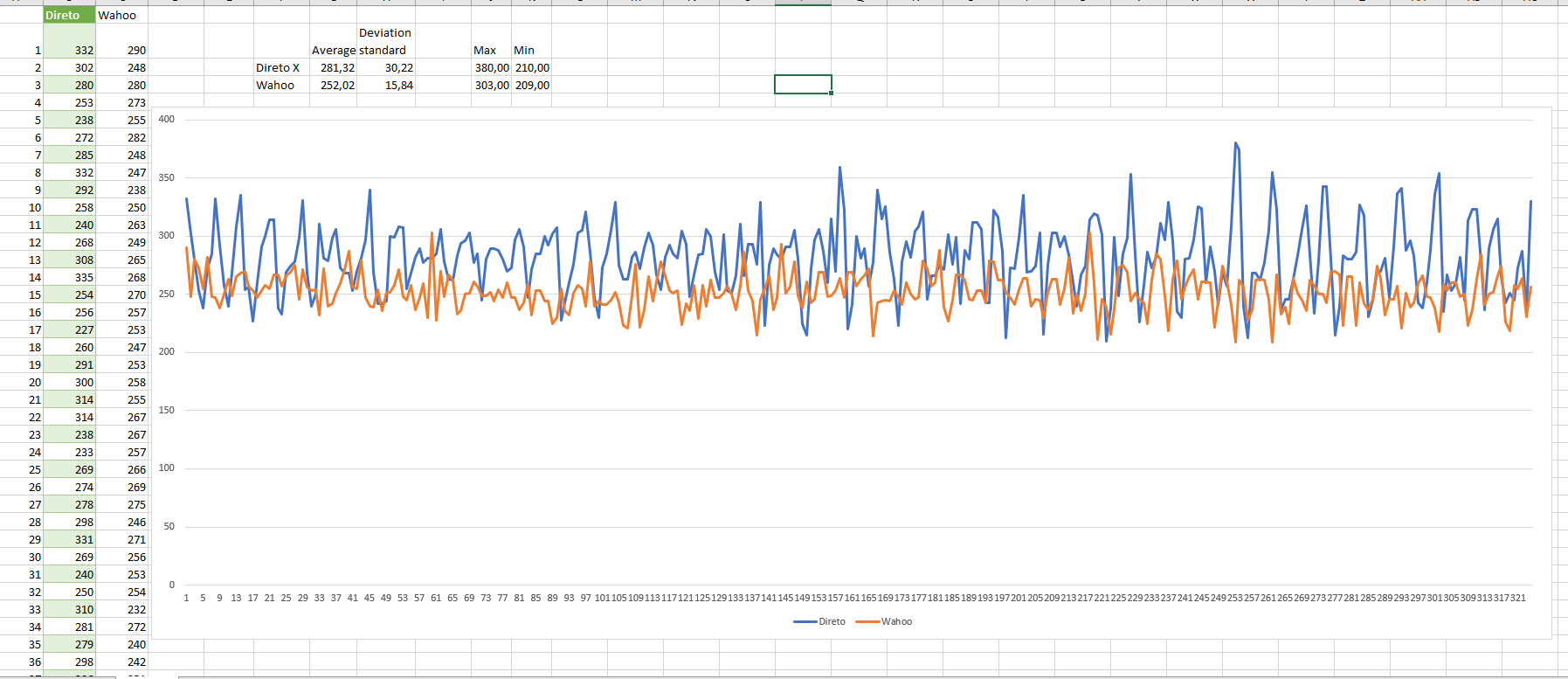

Stability of ERG mode. Direto X vs Wahoo kickr core.
Power measured by Assioma Favero DUO pedals.
- Screenshot_8.png (152.89 KiB) Viewed 36967 times
imarszi wrote:Stability of ERG mode. Direto X vs Wahoo kickr core.
Hi Imarszi,
just to be sure...
Did you test the same level (250w) with both elite and wahoo, but measuring the power values not with their internal power meter, but using the assioma, did I get it correctly?
So you are testing the "responsivness" of the ERG, in terms of requested power, by measuring with an external power meter.
This demonstrates that Direto has an higher scattering in the "requested power", confirmed by the assioma measurements.
Really good work.
Thanks.
Ernesto

jhankey wrote:I have attached a graph from my work out. Towards the right hand side you can see that the power drops considerably. My heart rate flattens and starts to lower, but you can also see in the cadence graph,I lifted the rpm, it was from 98 to 105+ to 'chase' the power up. It simply would not increase.
https://www.youtube.com/watch?v=7L7hfT0I7E0
Hi Jhankey,
yeah, the left part pf the GPLAMA chart is scattering, but it seems to me that the spikes are much lower than ours on Direto...
And moreover, the GPLAMA spikes seem less "predictable" than ours that have a real sinusoidal shape, up/down/up... like we can see in the image uploaded by Julien.
I'm still convinced that the resistance in ERG mode is adapting up/down too fast, trying to follow too quickly the cadence variation in reality even when the cadence is not changing.
I can get that amount of "movement" GPLAMA chart) only if I set the power smoothing at 6 or 10. While instead, on the right part of that chart, when wahoo smoothing is enabled, is not even immaginable with direto (and it is supposed to be when we set 10 in smoothing...)
At least this is what I get from the video...

enesto wrote:imarszi wrote:Stability of ERG mode. Direto X vs Wahoo kickr core.
Hi Imarszi,
just to be sure...
Really good work.
Thanks.
Ernesto

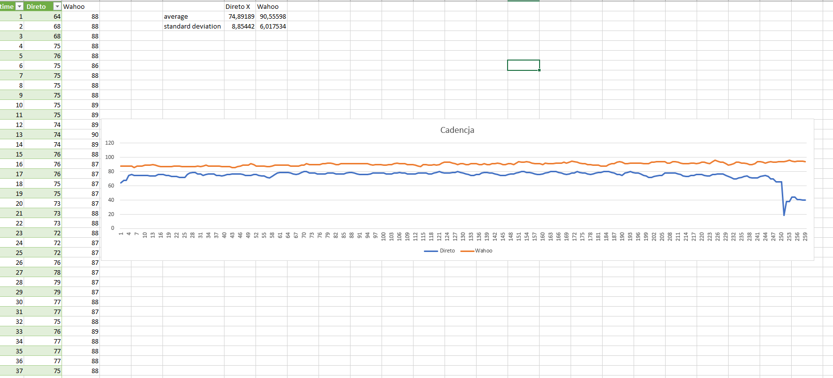

So the measurement was only from the Assioma pedals.
I have a Direto ride on 270W and a wahoo on 250W.
It is not a well-done study because there was a target for a different power. But I think it captures the love of ERG power for the Direto X.
These power fluctuations make it much harder on the Direto to finish the interval than on the Wahoo.
In the attached file the same for the cadence.
