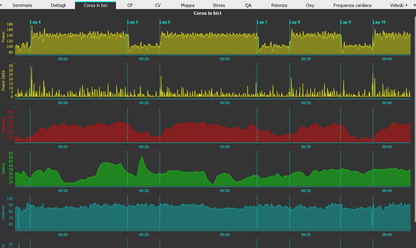

@Ernesto,
Here's one of your trainings. Oscillations are around +/-10W, but in some points +/-20.
If you notice, the oscillations are higher when cadence is less stable:
On another training you've sent, oscillations were bigger but speed was quite unstable, here I've changed the scale so you can see the speed:

@Ernesto,

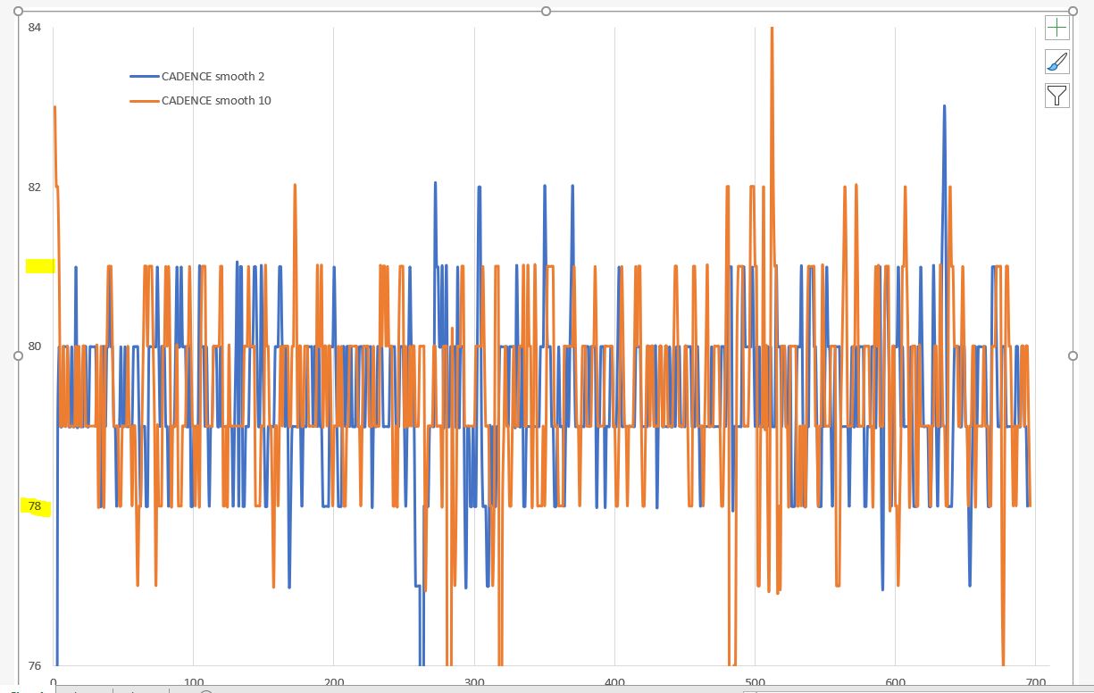

Now, the trainer is not moving, so we can check the cadence and apply the cadence to the gear used (again 34/16 fixed in my test) and the wheel circumference set in the app (2070)
Now, as you can see from my charts below, comparing my cadence in the two files I've sent, with the exception of some spikes (some under 78 rpm and over 81) I would say that the cadence is quite enirely included in 78-81 rpm and speed is included in 21-23 km/h.
78-81, on an average of 79, I would say it's the normal resolution of your internal cadence measurements 1/80 = 1.25% accuracy that is more or less the accuracy of any other cadence sensor...
Just to have some % these are the real values:
Smooth 10 test:
Number of observations 696
Less 78 rpm 27 observations = to 3.88%
Over 81 rpm 16 observations = to 2.30%
Between 78 -81 653 observations = to 93.82%
Smooth 2 test:
Number of observations 694
Less 78 14 observations = to 2.02%
Over 80 7 observations = to 1.01%
Between 78 -81 673 observations = to 96.97%
I would say that, between smooth2 and smooth 10 test there is no big difference, and probably, during the smooth10 test, I had a worst cadence stability, but this translated in a better/lower scattering in power values.
So you're still convinced tat a 97% of cadence included in 78-81 rpm over about 700 seconds of observations is not a stable cadence. Really?
And again, smoothing 10 is giving low scattering because the values you're logging are not stable, and an higher smooth value is adding a sort of compensation.
I'm not the only one concerned about this, you can check it on FB Direto X etc. Group, in these last days, other people are asking the same things I'm asking here.
Last chart is confirming what I'm trying to say.
Blu line is the difference between cadence from one observation to the next, orange one is the same, but for the power.
Grey line is the actual power otput
You can easily see (I've just selected from 500 to 585 observation just to zoom in excel, in the middle of last 150w interval) that cadence is moving around 0,+1 -1 while the power has movement of + - 40w)
Doing the same with smooth 10 gives best results, you can see orange and blue line are quite completely flat, and the grey one is less scattering + - 10W)
This behavior is spread all over the file.
Smooth 10 test:
Smooth 2 test:
Again, if everything's normal and these are the results of the Direto XR in ERG mode, I'm fine with it and all other people with my same doubts should do the same.

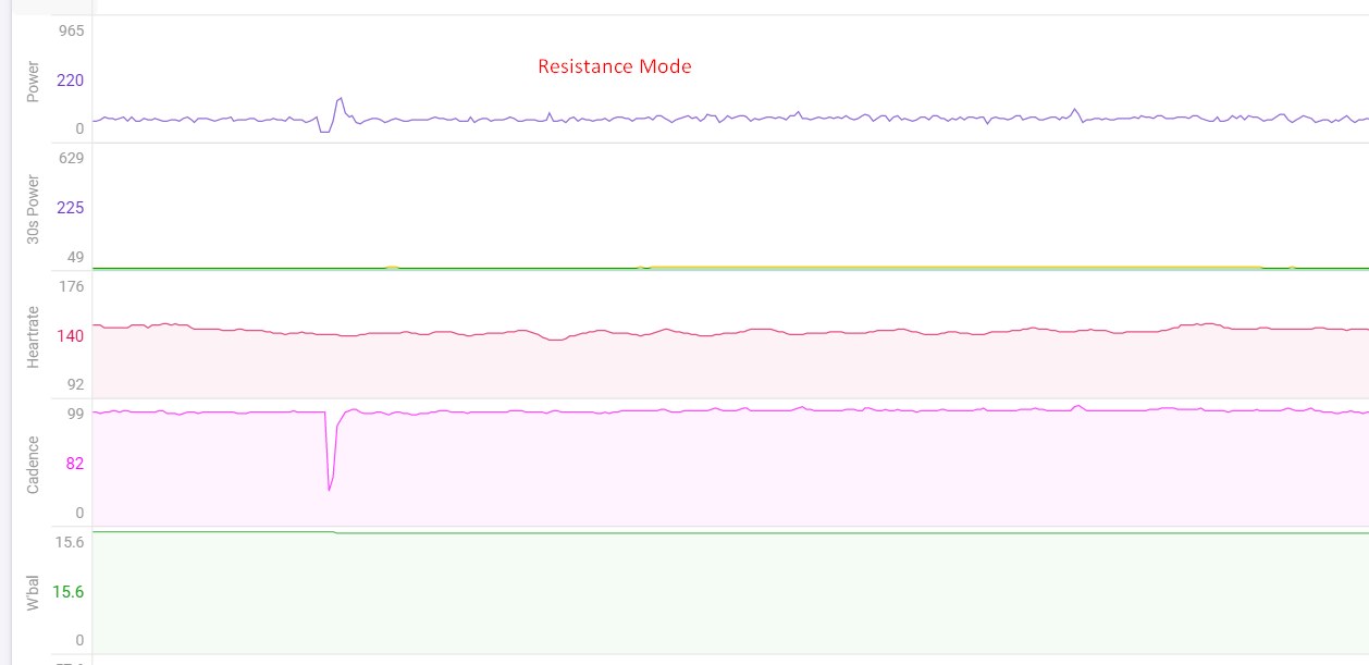

+/- 10W is OK
I have +/- 100W. This is totally unacceptable and therefore the ERG mode cannot be used. In resistance mode, I can keep the power constant.
- res_mode.jpg (42.12 KiB) Viewed 75588 times
- erg_mode.jpg (72.48 KiB) Viewed 75588 times
