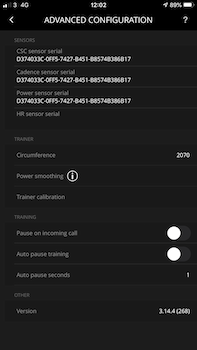

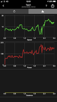

I have just bought a Direto X last week and I am using My E-Training app on iPhone 7 plus.
Yesterday, I noticed that My E-Training app doesn’t show any information on cadence, and measures very small values for speed. I have attached a screen shot of the Advanced Parameters for your attention along with screen shots of power and speed graphs. As you can see, the speed registers normal values for the 3 minutes ride on 29/03/2020, while only shows very small figures for the two short runs from today. I don’t know what is different as I haven’t changed anything. Though, my Garmin watch has detected the speed sensor and shows both speed and cadence normally.
I have then switched to Zwift and I realised that the resistance fluctuates to extremely high levels despite of cycling at -1.2% slope. e.g., when start riding in NYC on the central park loop, the resistance will suddenly release extremely, following by an increase to what feels like max resistance.
Any idea how to resolve this?
