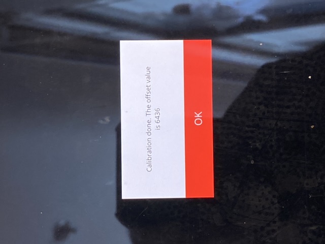

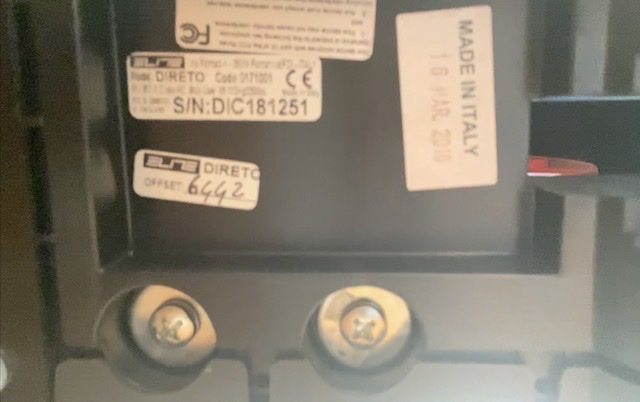

What is the first step in adjusting? Loosen the sides first?
Am i reading the value right? Is it 6442?

Hi guys
@apditangco, the value on the label is 6442. This means that your offset value is under of only 6 points.
It's normal to have a decrease in the offset value. It is due to the fact that the belt is adapting to the mechanic of the trainer.
There is a problem only if the decrease happens and at the same time you notice one of these issues: sudden drop in power, strange noise, slipping at high power. Only in this case you have to tighten the belt.
As the procedure of tightening the belt is a little delicate, we prefer to be contacted (myetraining@elite-it.com). We will give you complete instructions after verifying that the situation requires this operation
